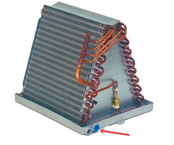

What i’m imagining is spray foam that got into the pan and leads to a clog. Or spray foam that got on the coils/fins. Who knows how much was sprayed inside. It just kinda… keeps going, you know?

To start, do we know this plug was removed?
If not, it would be hard to get foam into the pan, unless they shot a whole can in there.
Is the water all over the floor? I don’t see that.
If the pan is blocked, it would overflow all over the place.
One other thing, that unit does not have an A Coil as your showing.
No, you can see the red secondary drain cap if you look close enough. there is no secondary drain, just a float switch on the primary.
Not at the time of inspection, so that’s a good sign. What happens to spray foam after getting hot air blown over it for a couple winters? maybe a little piece falls off?
It looks like it may be, judging from this illustration in the installation manual. But the fins and coils looks like they are a good bit away.

This looks more like the configuration that was the OPs picture. Note the closeness of the lower freon line to the drain. In original photo, you can see the foam inside the evaporator housing and to the right of the freon line.
Well there ya’ go. Spray foam is not putty or tape. Not a recommended sealant. You have your defect :grinning:
