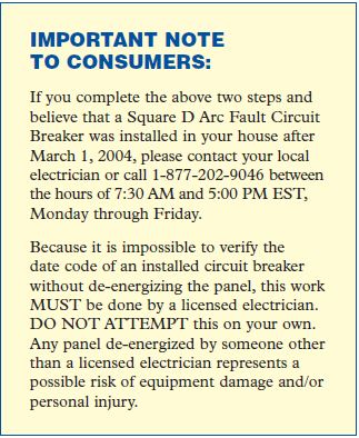

Your thoughts on Square D’s comment?Square%20D
Think that they meant using NFPA 70E or OSHA Regulation 29 CFR 1910.331?
Can you put this in context, where is that note from and what is its purpose?
https://www.schneider-electric.us/en/faqs/FA130670/
Found it
