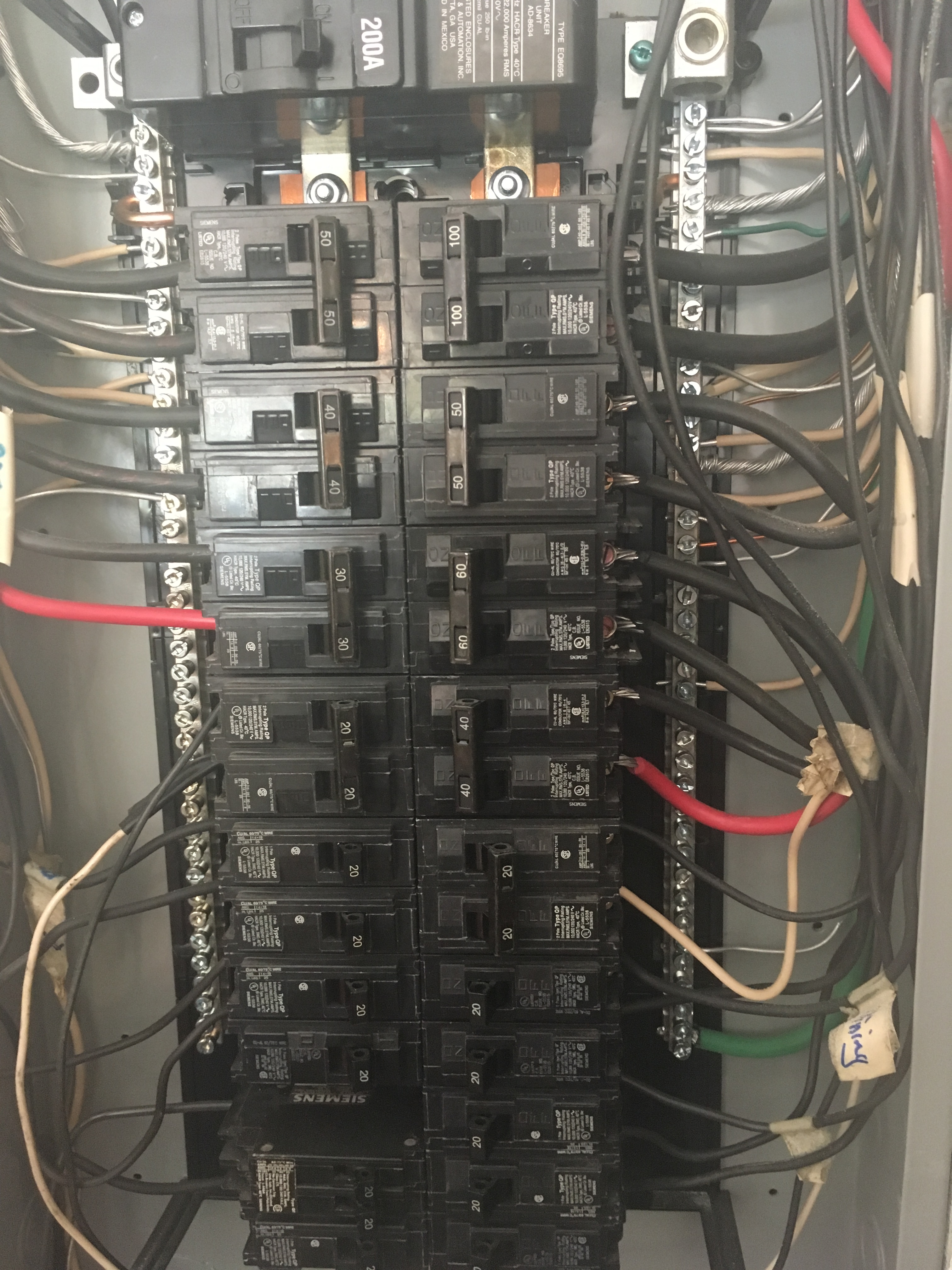

In the photo of this 200 amp service electrical panel there was a couple of double lugged wires. Also there was a white wire that should have been taped coming from a breaker. There was also a large jumper wire between the bus bars running over open live hot parts of the panel. Panel should be further evaluated by licensed electrical contractor.
The jumper was probably factory installed.
