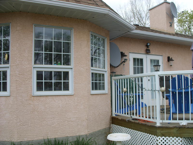

I am presently taking this coarse on Stucco & EIFS Inspection and was asked to comment on a picture related to the course. The house in this picture is a traditional three coat stucco system and is about 21 years old. There is a few small cracks above the door and below the window on the left side.
Regards Perry Schopff
I have completed a visual inspection of this 21 year old property and found the exterior cladding appears to be 3 coat conventional stucco. There are several small cracks mainly above and below the corners on some windows and doors. All the flashings appeared to be in place. The parging below the stucco will need to be repaired as several areas are showing age and have slid down.

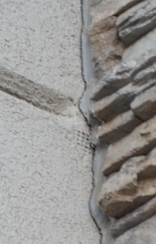

Attached are several images of a commercial building that had both manufactured stone and EIFS installed. Although I was unable to determine the precise type of EIFS I did rap on it and heard the hollow sound typical of EIFS due to the very thin stucco layer and the underlying plastic foam insulation.
I noted that the interface between the stone and the EIFS exhibited a caulked joint that was pliable and was supported by a backer rod, however the entire length of the caulked joint had pulled away from the stucco rendering the caulking ineffective for moisture intrusion control. This should be rectified.
On another part of the wall I noted partially exposed fiberglass mesh. This mesh should be fully encased in the stucco. This is an indication of poor workmanship but does not necessarily need to be repaired.
I recommend a third-party inspection be performed by a qualified stucco inspector.

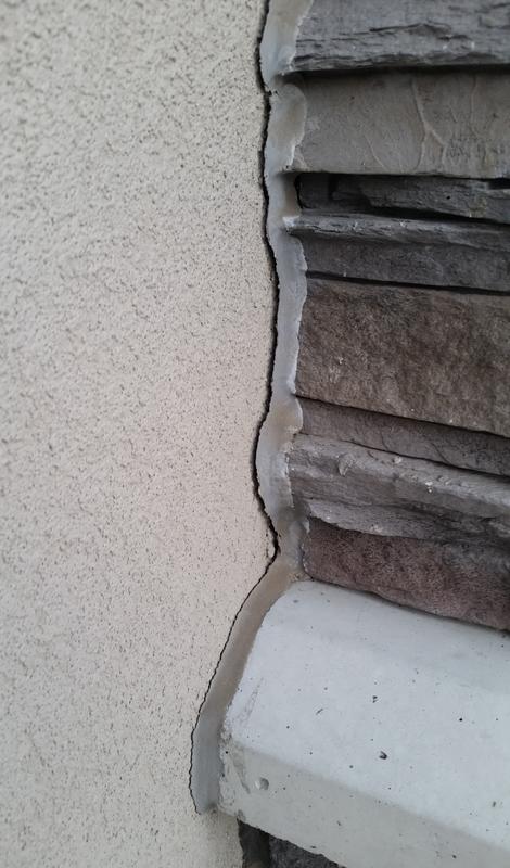

I performed a visual inspection of an EIFS finish on a commercial building, with the intent of determining if any moisture intrusion had occurred. The system appeared to be MD EIFS that had been installed, alongside manufacture stone, on new construction within the last few years. I observed no visual evidence that moisture had entered the system and caused damage however there was an area of concern detailed below.
The vertical caulked joint between the manufactured stone surface and the EIFS was perhaps 3/8" maximum, and less in places where the stone protruded towards the EIFS more closely. This small gap was sealed using backer rod and caulking however the caulking was more of a fillet-type profile in the places where the gap was minimal.
A major concern I had with this caulked joint is that the entire bond with the EIFS had pulled away, leaving an approximate 1/8" gap where moisture could enter. Virtually all of the vertical caulked joints suffered from this phenomena. The system should be inspected by a third-party EIFS inspector to determine the required corrective measures.
The rest of the EIFS installation appeared sound and was in good condition with no signs of impact damage or moisture intrusion.

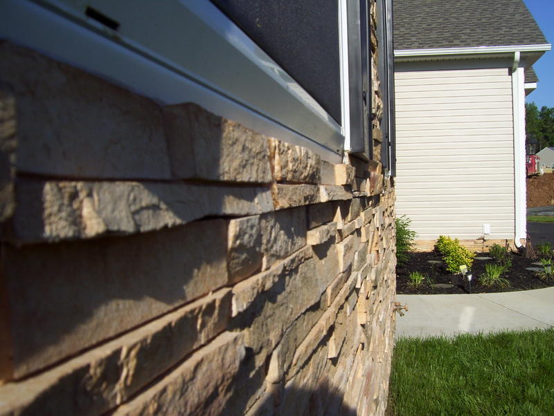

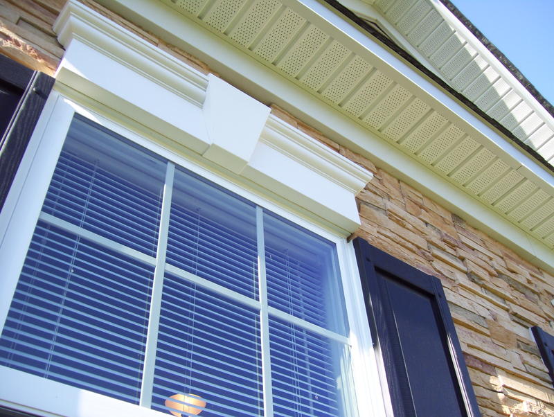

Hi everyone:
I want to include a few pictures of man made stone installed on a newer home .
The pictures show two large gaps for water intrusion at the top corners of the shutters. Also included are the window sill shots showing how some of the stones top surface run back toward the window which allows for a water to drain back toward the window instead of away from it…
thanks
Nat

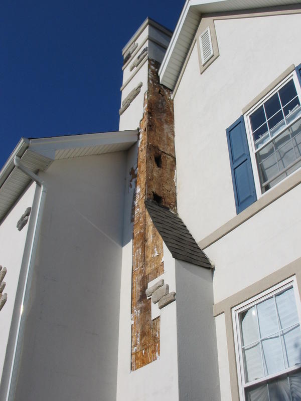

Hi All…Great class. This is a picture of a barrier EIFS system that was not correctly flashed were the chimney meets the roof. It illustrates the damage that can be caused when EIFS is not installed properly.
Dan

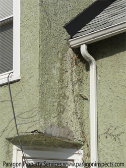

This is a house that has a kick-out flashing missing and water has been penetrating the system for quite awhile. While there is a lot of visible damages showing, This definitely needs to be investigated further to see how much damage has been caused.

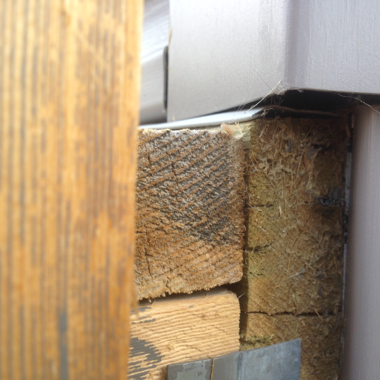

Here is picture of flashing above a deck that is terminated too short. It also doesn’t have an end dam. It is also made of non-treated lumber.

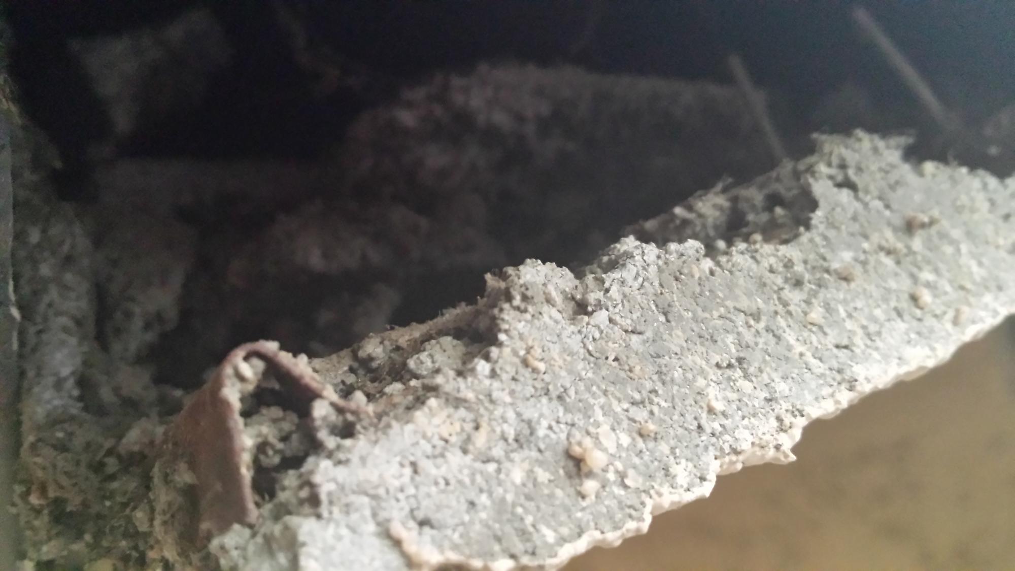

Picture: you can see in the picture the stucco is thin, missing, cracked, prior repairs have been made, insulation board is exposed and the base coat may be missing.
Inspecting: I imagine a lot of clients will have concerns when they see cracks in stucco, being able to confidently explain the material, how its installed and assess the crack(s) could be a valuable skill to put things into perspective and relax a client.

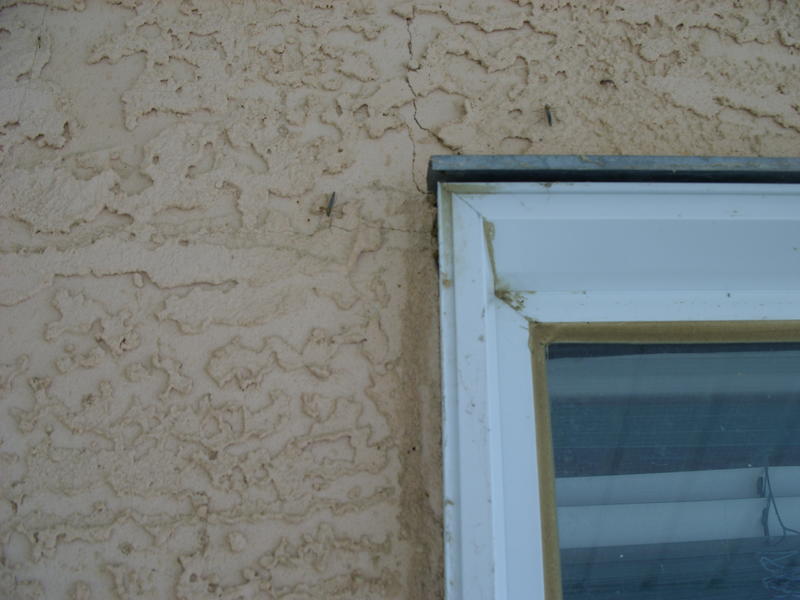

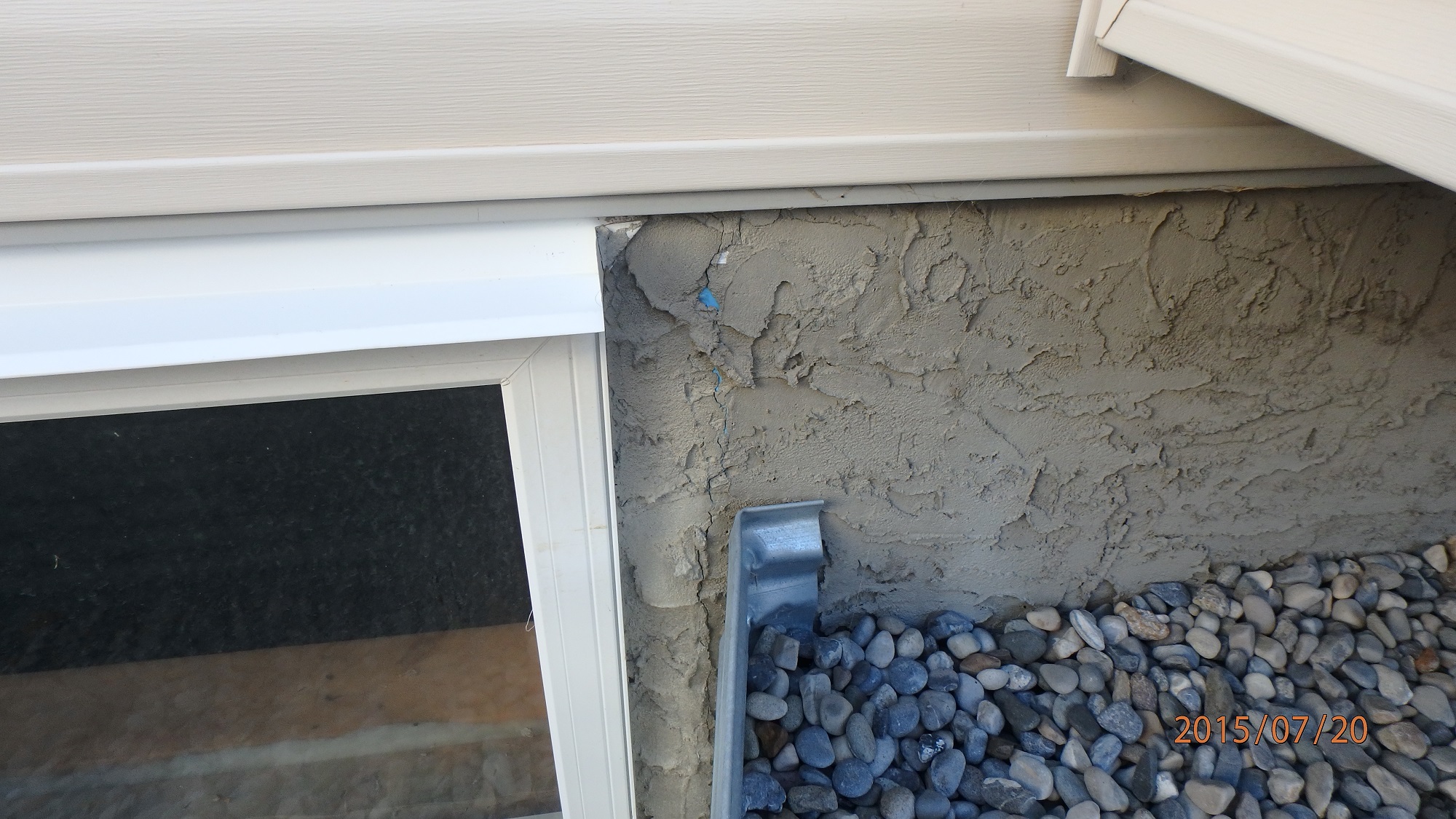

Improper installation. Stucco butted right up next to rock wall with no expansion joint.
There seems to be a lot of people out there installing stucco incorrectly. I rarely see an expansion joint between dissimilar materials and windows. Instead of using a flexible sealant, they are grouting the joint. This seems like cracks just waiting to happen.
