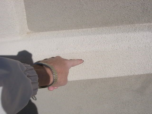

Around every window and any other Pop-Out in the stucco they Forgot to install Lath…:twisted:
I can stick my fingers through areas where the stucco 1/16th of an inch is not laying on the ground or laying on roof tiles below the windows…:twisted:

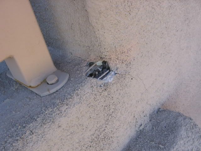

The wood trim at the bottom of each door has large gaps and is not sealed-finished-painted…:shock:
Holes like this all over the house…:twisted:

They usually install a vapor barrier against the exterior wall studs, staple styrofoam and chicken wire to the entire exterior, and slap on two coats of stucco which are supposed to be a minimum pf 3/8ths of an inch.
If I want to, I could push my finger through any portion of the exterior walls, I just pushed my fingers through the pop-outs which already had the stucco laying on the ground because there was no lath, they simply smeared a 1/16 of an inch over the styrofoam.
