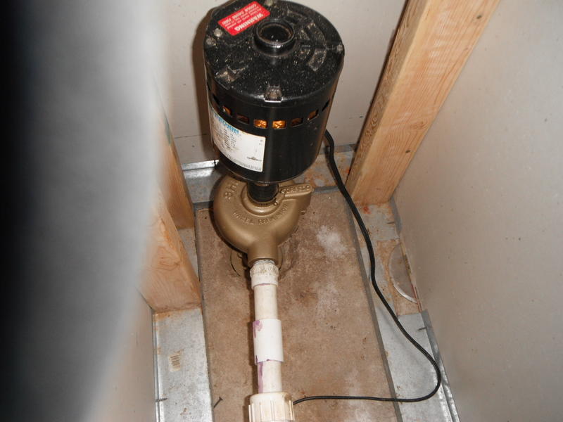

What is the correct name for this type of pump? It looks like an ejector pump for sewage but not being used it that way. It is located in the basement and I assume it is connected to the a french drain or floor drain pipe and designed to eject drain back up if it should occur. The drain terminates to the exterior.
Is there a bathroom, shower stall or other component behind the wall to the right of the photo?
It is not a sub drainage pump.
It is modified for unusual practice I suspect.
The year of the house and some more photos please.
Exterior drainage shot and more shots of the pump further awy to include a larger view.
Some older homes had weeping drainage.

It is a Brass bilge pump. I would suspect they needed it because they could not find a strong enough sump pump to push the water the required distance up and out.
This type is used for high volume water removal during floods.
I will also say that it must be sealed but I would not leave the extension cable on the floor for supply to the unit.
This type of pump installation was offered to home owners by the city for those home owners who do not have a sump pump. The discharge pipe exits through the rim joist and terminates about 12 inches from the foundation directly on the grade. There was a big push by the city about 15 years ago. I need to call the city to find out more about the installation.
Let us know John why it needed a stalk if it is not in a submerged sump pit?

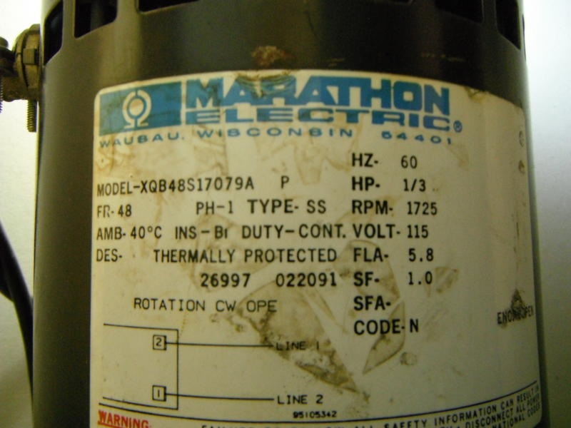

Also why it has not been supported on the 1/3 hp motor?

Late to the game but these types of pumps are common in 1950s homes in the Detroit area. It’s just a sump pump of a different style. They typically have a test switch on the side.
