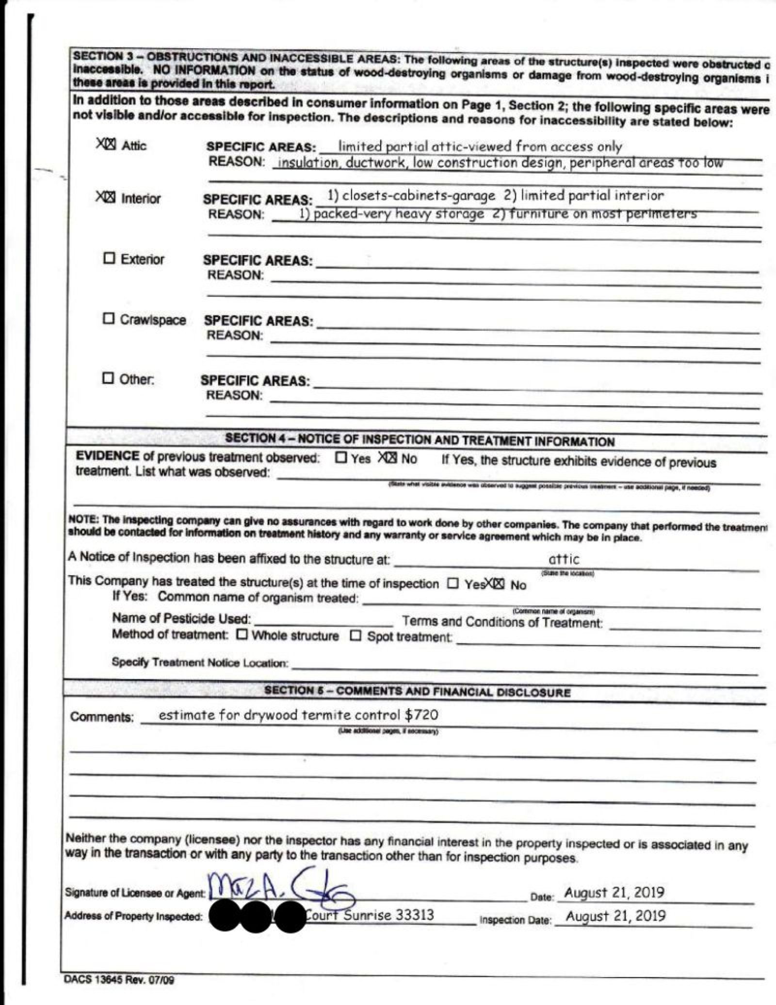

My WDO reports usual limitations (on the home inspection report also)
Areas not inspected:
  1. closets-cabinets-garage 2) limited partial interior 3) limited partial attic
1)packed-heavy storage 2) furniture on most perimeters
3) insulation, ductwork, low construction design, peripheral areas too low
here’s a second page
