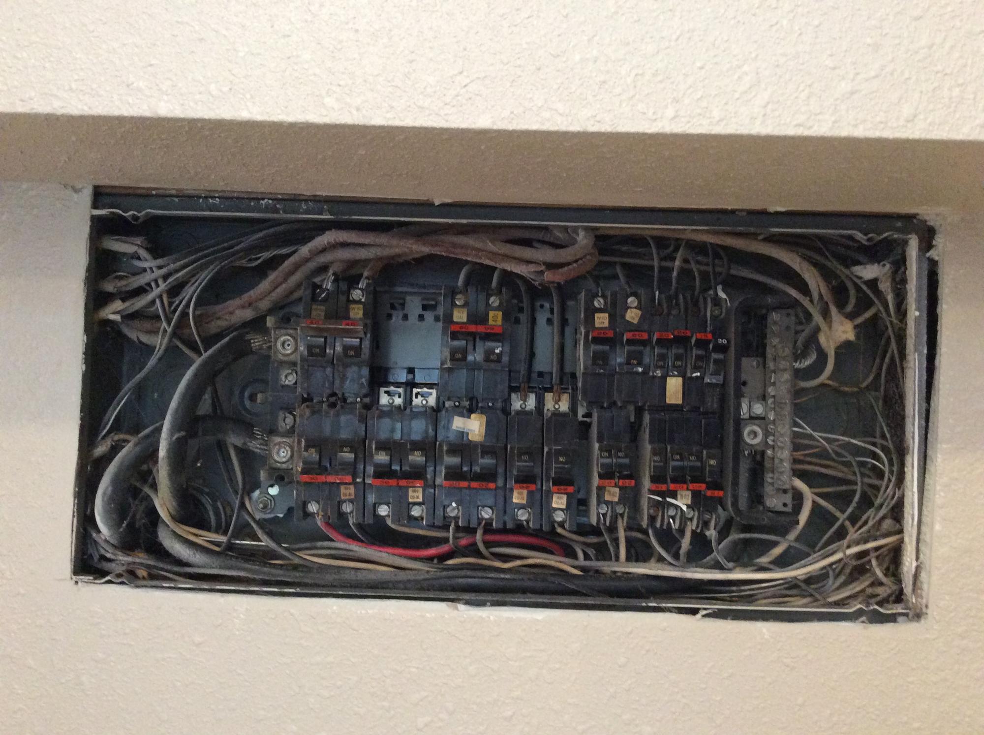

I am on an inspection and got this image of the electrical panel. Any thoughts about the IR image? Yes It is a Federal Pacific panel and yes there is solid strand aluminum wiring.

“The neutral wire appears to be hot. This may be an indication of a loose connection. I recommend having a licensed electrician repair as necessary”.
Yes this was just with my cheapo FLIR 1 because I had it in my pocket. This is solely for learning purposes.
What was the temperature of the above stated connection?

Despite the low resolution of the thermal image, it would appear that the hottest point in the panel is the main lug for the neutral conductor. As pictured, the lug appears hotter that the insulated portion of the cable.
Given the fact that the emittance of the lug is lower that the cable jacket, this thermal pattern is typical of a loose/deteriorated connection and you would be entirely correct in recommending that a qualified professional investigate the cause and take appropriate corrective action.

What would you expect the measured load to be on the neutral on a single phase panel?
I would disagree.
There is nothing in this scan that indicates anything.
A thermal camera can be tuned to make anything look like it is on fire, when it is not. (I do not expect that any tuning of this scan was conducted beyond the Auto Mode).

I would be more concerned about these two issues as they are on 2 poll circuits. Why the imbalance? But it is a split buss panel.

In the absence of significant harmonic content or losses due to ground fault, the amount of current being carried by a neutral conductor should equal the current being carried by the corresponding supply conductor.

Without temperature readings, the photo is meaningless.

The neutral conductor should equal the current being carried by the corresponding supply conductor. Conductor or termination temperature can very due to several defects or deficiencies.
The temp on the neutral should be roughly the same.
Question, is this FP panel a main or sub panel?
The hottest point in the panel appears to be at the neutral termination.
IMO it appears to be a sub/remote panel. I see no main disconnect.
OP, what type of panel is it?
Readings or not thats a loose lug!!!
