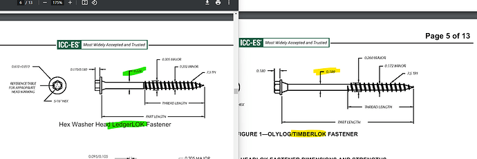

I’ve been trying to decide how I feel about these timber lock bolts being used in place of lag bolts or ledger bolts to secure the deck ledger to the home. I’ve never seen them used for this. Is this an Issue or not?

The TimberLoks have a smaller shank diameter than the LedgerLoks.
Look up on their web site to see if they have IRC special code approval.
IMO, they don’t look like structural screws appropriate for that application. My guess is they are not appropriate. I don’t see an identifying stamp on the head. You’re going to have to become familiar with what is code approved and used in your local area. Of course, galvanized 1/2 inch fasteners are the universally approved fastener.
When I was a contractor, we used structural screws from GRK. The “RSS” screws with a larger head have code approval for deck ledgers. “RSS” is stamped on the head for identification. GRK has special code approval documents on their web site.
The smaller size is what concerns me and the small head as well.

As an edit here is the document.
I’m assuming these are timberlock bolts as they sure appear to be based upon passed usage I’ve been searching the sites and found “TimberLOK screws replace 3/8” lag bolts in a fraction of the time" 3/8 is not 1/2 so I’m calling it not good enough which is par for the rest of the deck. Needs full evaluation and repairs.

I incorrectly mentioned Simpson Strong Tie screws in my previous post. LedgerLok are made by FastenMaster and are designed to replace 1/2" Lag bolts and are approved for attaching the ledger board to the house. If those are LedgerLok screws (not TimberLok they look similar) there is no issue when spaced properly.
