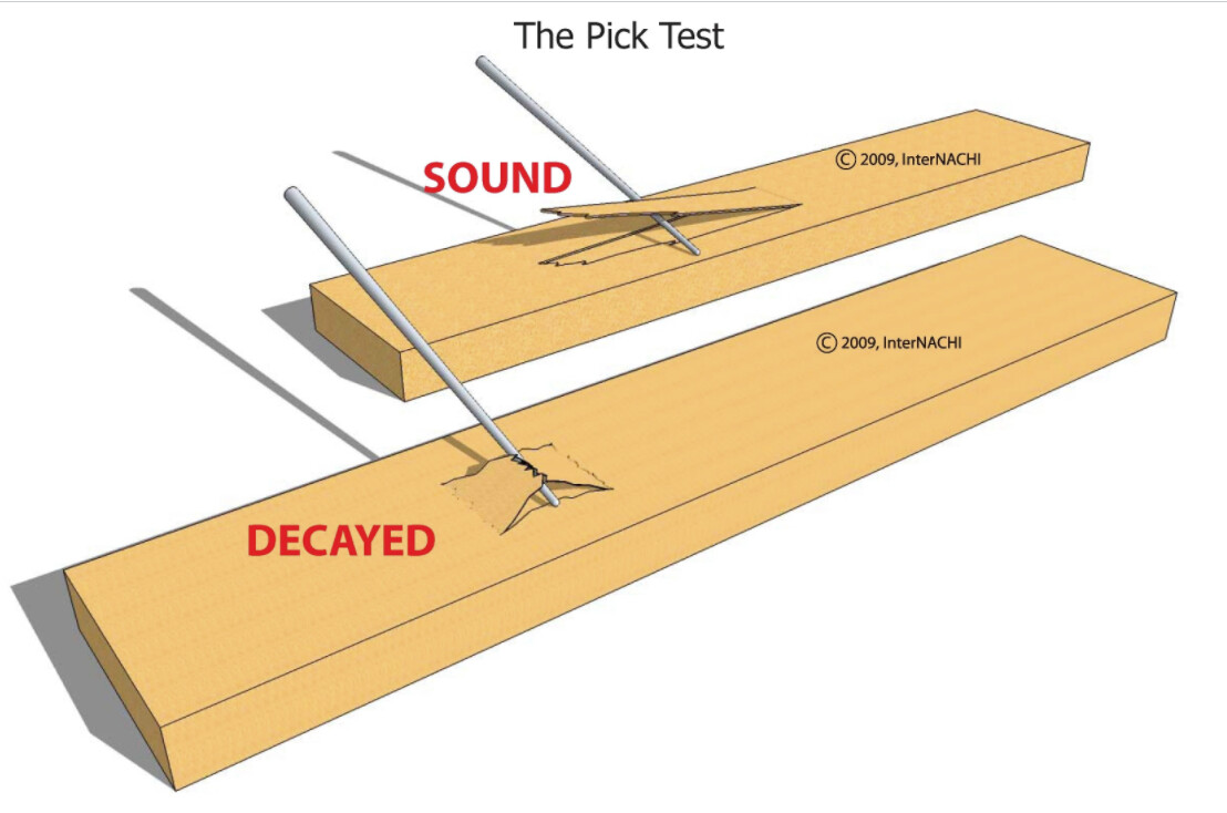

To probe or not to probe wood
I’ll be honest, sometimes for me it is not completely obvious with pressure treated pine. I will dig out a little soil and do this.
This is another area where Nachi SOP and Indiana SOP differ. Indiana addresses this specifically:
d) Structural systems requirements are as follows:
(1) Licensees shall: (A) inspect:
(i) the structural components including foundation and framing; and
(ii) by probing a representative number of structural components where deterioration is suspected or where clear indications of possible deterioration exist, but probing is not required when probing would damage any finished surface or where no deterioration is visible”
Indiana does not define “probing”, but the Oxford definition of “probing” is to “physically explore or examine (something) with the hands or an instrument.”
So, if I want to pick-test it or just knock on it with my knuckles, I am required to “probe” suspected deterioration unless damage to a finished surface would result.
