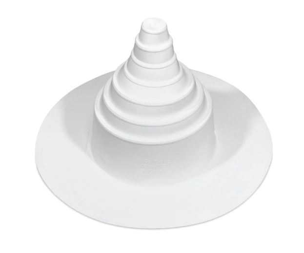

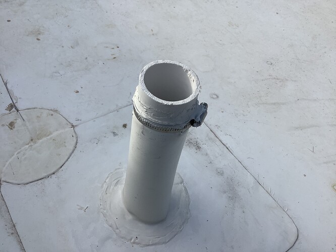

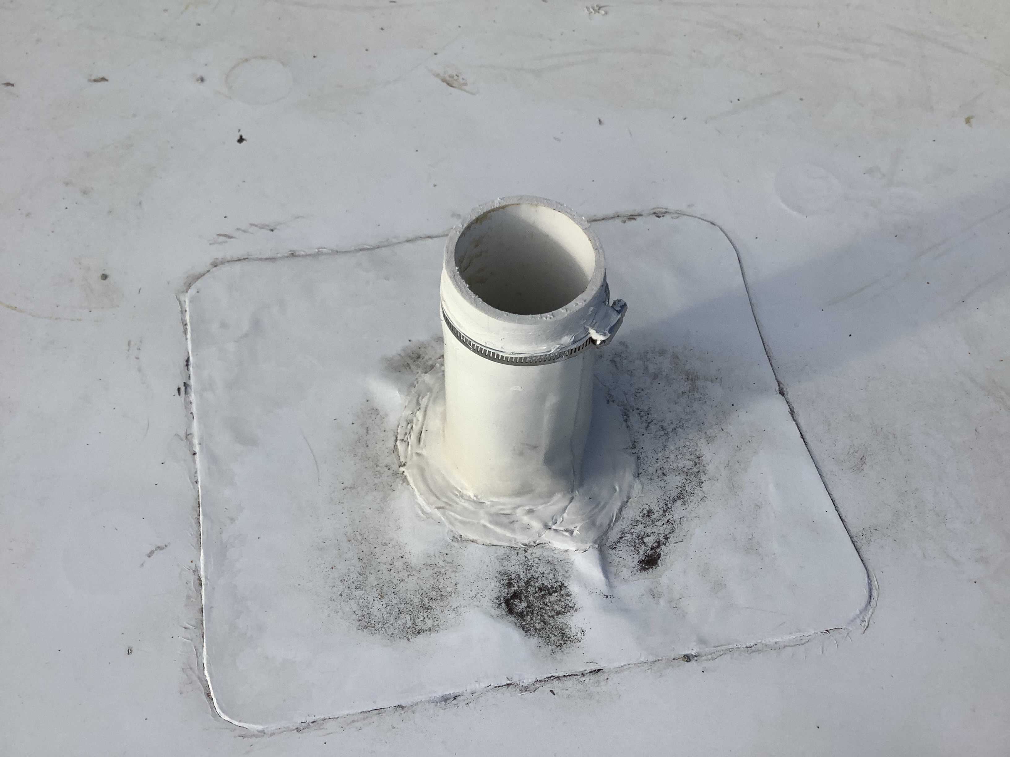

TPO Boots do not look like standard ones
Just inspected a 2023 TPO roof and these were the boot’s installed at the vent risers. They don’t look like the standard ones used. Roof was permitted and signed off by city. Any comments on them, they don’t look right to me

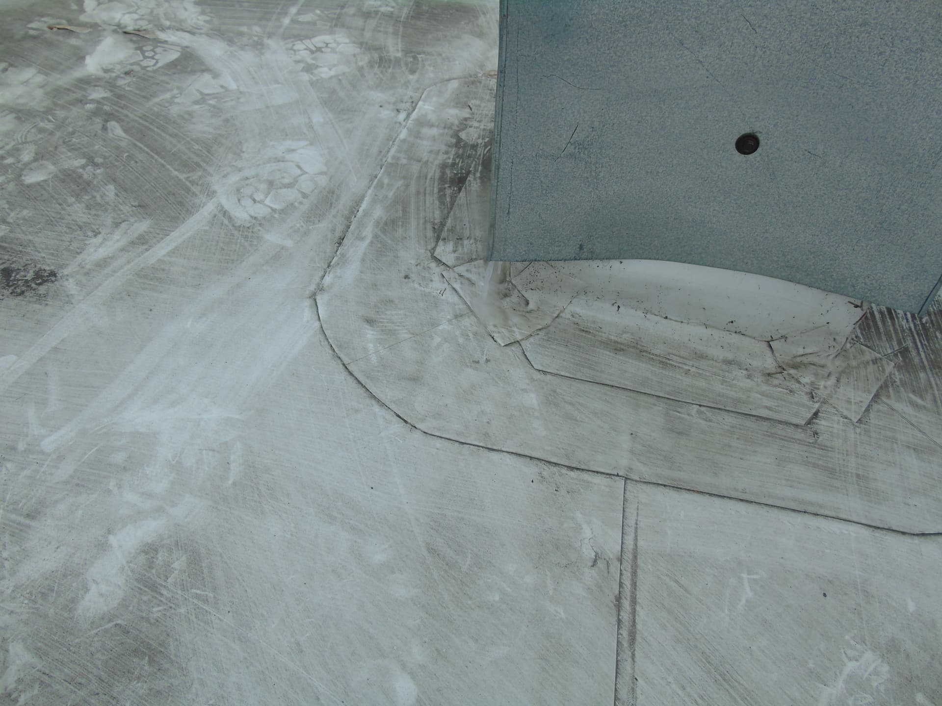

Roof Vent Curb TPO Seal damaged.

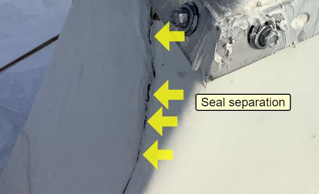

tpo seam seal damage
Thank you for that website :+1: yes seen that separation :pensive:
Thats typical for what I see
From 3 days ago. Drain block and water leaked following the main waste plumbing vent stack to the basement garage. Mostly curb and box stripping issues, as well as a cant strip from the old T&G roof covering was left on the firewall.

The mechanical collars are left out all the time, yours look pretty good (call out that separation noted though). Sometimes the collars are too low or no sealant at the top, again yours are good.
