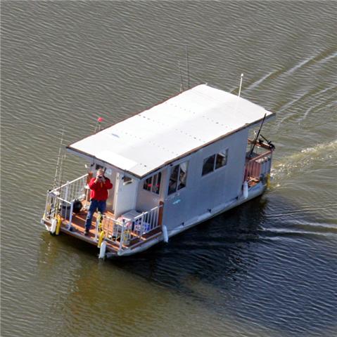

The trolling motor on my house boat got it around fine on a lake in no wind conditions. FWIW.
Edit… this is the boat I am referring too.

If Samuel gets around with a houseboat it should be fine for my sailboat.
