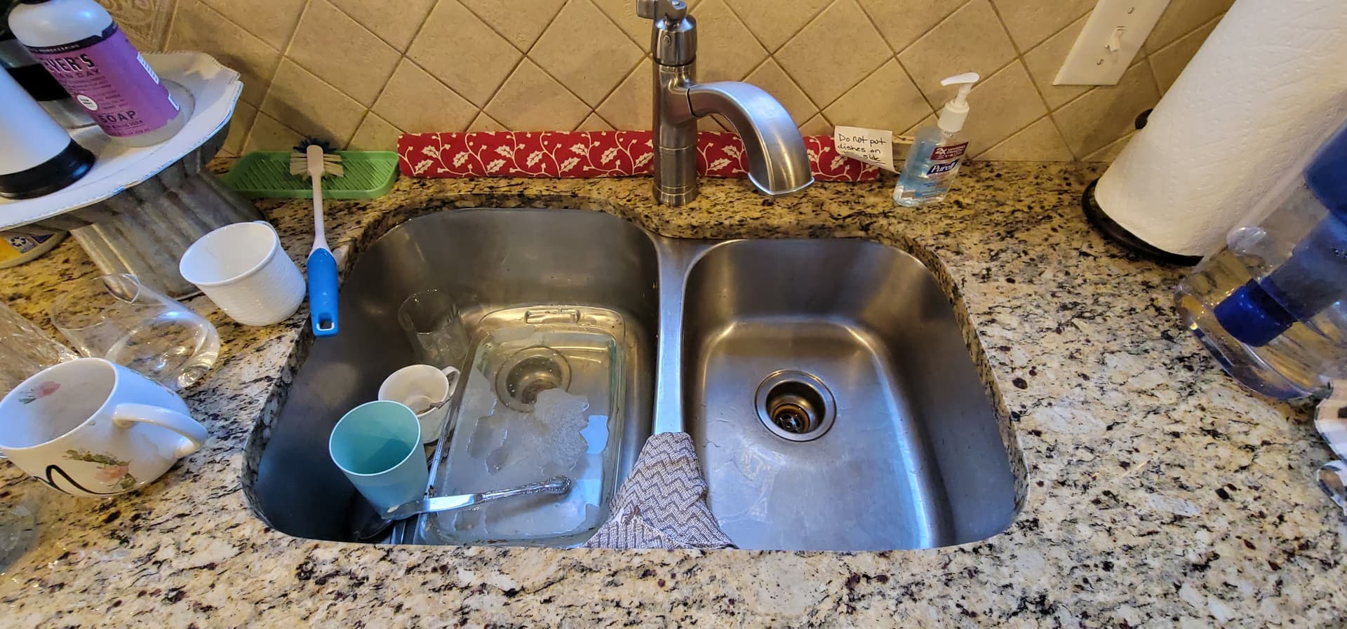

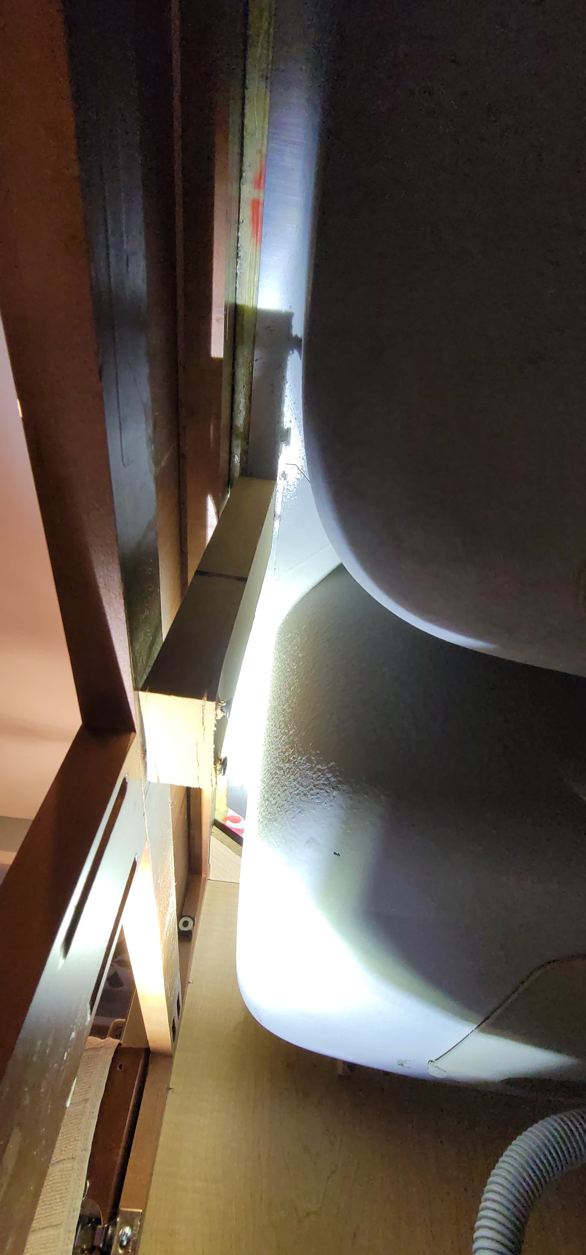

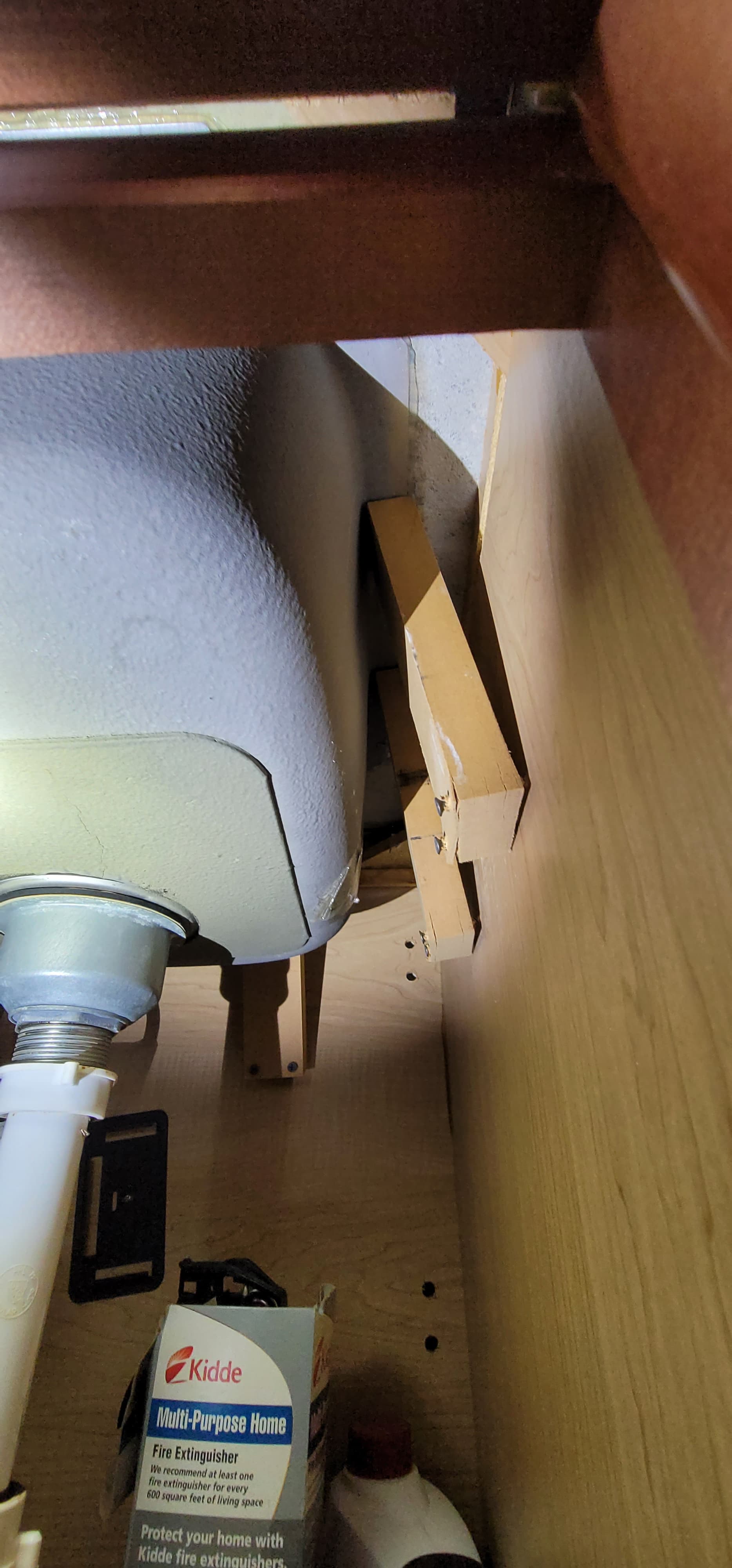

I see a lot of references online saying silicone or appropriate adhesive by itself works fine for many. I suppose it depends on the weight of the sink, how well the surfaces were prepped, and if the correct silicone/adhesive was used.
I’m not sure I would trust many installers to get it right, especially the surface prep part. So for me, I would want clips or some other underneath support method in my own home, just for peace of mind if nothing else.
As far as inspecting, if the sink appears to be holding well, I probably wouldn’t call out missing support. It seems to be one of those drip leg/dirt trap deals where it depends on installer’s preference and what has worked for them.
I’m not a licensed plumber but in my former life as a contractor I’ve installed several dozen kitchen cabinets, bath cabinets, sinks, faucets, etc. and everything in-between. There are many different types and styles.
In regards to the OP, I’d say it really depends on what I would consider documenting a concern or defect. I’d have to see it in the field. I’m ok with both methods.
I do know it’s near impossible to get mechanical brackets/clips on the underside of a tight space.

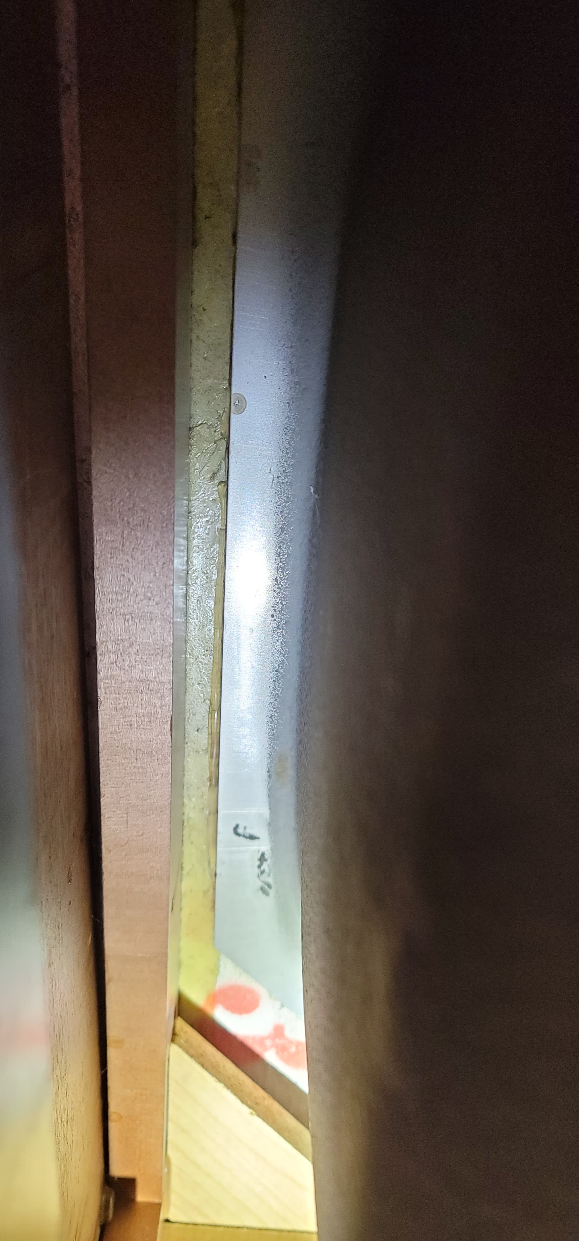

Here’s a pic of my personal sink and they way it was mounted. I bought this house new 17 years ago. It’s held up quite nicely :slight_smile:

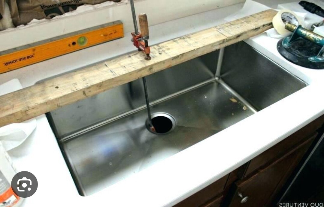

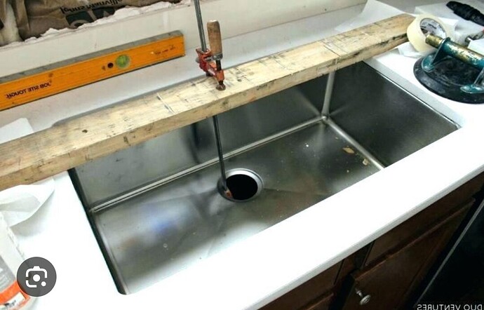

This is exactly how I’ve seen hundreds of sinks installed. (Kitchens and bathrooms)

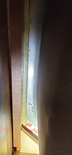

The clamp holds until the silicone or epoxy was dry.
similar to what I used to see in the field,
Agree 100%. The clips that hold the sink in place for the silicone to cure aren’t always accessible or the holes were never drilled in the granite or corian to accept the clip insert.
Do you think this professional used a bonding caulk that can be cleaned up with water or is a solvent like mineral spirits needed?
