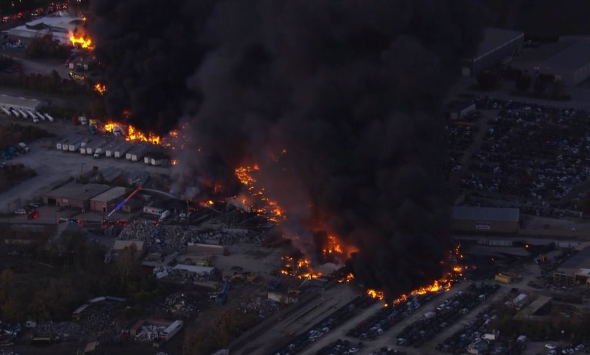

NEW: The NTSB has released footage of the damage swath following the explosive crash of UPS Flight 2976, whose left #1 engine detached and fell off during takeoff from Louisville, Kentucky on Tuesday.
The death toll has risen to 13, including 10 persons on the ground, with another 8+ people unaccounted for.
The damage swath is approximately a half mile long.
Death toll is now 14 as of yesterday. This could have been so much worse if they were airborne a little longer as where they crashed was in an industrial area along with the time of day this happened (5:14 pm) most employees had left for the day, a little further south from the runway you start getting into neighborhoods, Schools, Interstate.

If an engine fell off the plane as it was attempting to take off, it’s possible it may have been from metal fatigue, but IMO it was most likely a maintenance issue.
A very similar incident happened to an AA DC-10 in 1979 taking off out of O’Hare after a maintenance crew improperly installed the engine using a fork lift. :man_facepalming:

The NTSB was ultra-quick to release the preliminary report and ground both the MD-11 and DC-10. That must mean that the cause was obvious to them. I suspect it was metal fatigue (cracks) in the pylon mount(s). In the picture the NTSB provided, there was no evidence of material strain / deformation (overloading) of the mounts. I suspect it is simply aging of the airframe and likely lax inspection schedules (not expecting cracks in that location, since this particular failure hasn’t happened before). It was a tragedy for all the people involved and will probably be a long time and expensive to get the planes flying again, if ever. My understanding is that FedEx, UPS, the USFS, and a private refueling service company are the only operators that will be affected, around 15 planes or so. No passenger airlines fly the DC-10 or MD-11 anymore.
It’s not worth it to fix a 50 year old airframe that is not very fuel efficient.
They’ll be picked clean like Thanksgiving turkeys, the good meat (engines, gear, avionics) will be taken quickly. The gear mounts, wheels and whatnot might eventually get pulled. In the end, the remaining 7075 Aluminum and maybe a little titanium will be melted down and probably flying again in some other plane.
