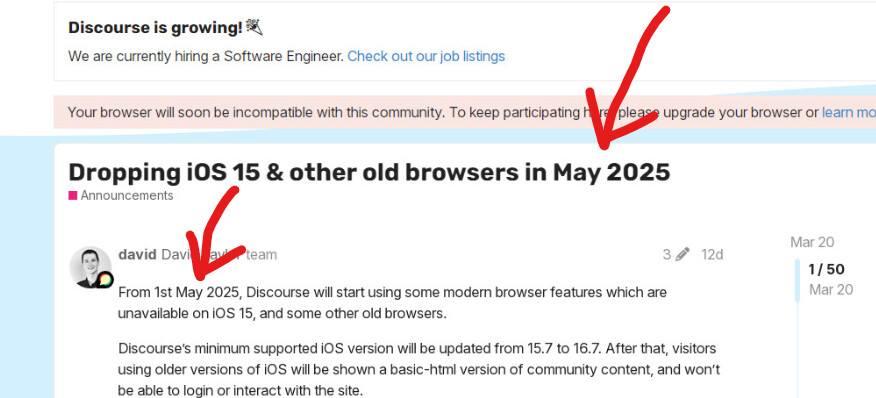

Anyone here noticing lag times when posting? There appears to be a 2 or 3 second lag time before my strings are posted or even logging into the MB in general.

Likely related to the Forums changeover BS… AGAIN!!
https://forum.nachi.org/t/looks-like-its-time-to-dump-this-pos-forum-system-again/254420

Likely so Jeffrey. Happens every now and then per year.
Good post and imbedded link by the way.
