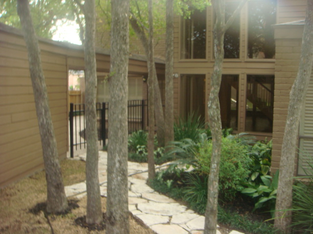

What do you say as far as removal of trees that have been in place for 22 years? Or do you just recommend a root barrier and trimming branches and leaves away from roof, walls, etc? These are mostley oaks with some pines.

The confusion I get into when trying to explain this issue to the buyer or correct verbage in the report. do you advise the client (with my pics of the oaks) that the trees may need to be removed or would you advise putting in a root barrier or simply recommend consistent watering. If the trees have been in place for 20+ yrs isn’t a barrier or simple removal going to cause the home to shift significantly?

Are you an Arborist? If not you should defer it to one if you are not an expert. The fact that you suggested removing them without that expertise would be beyond your scope of inspection in my opinion.
Would someone with experience in dealing with trees near the home please jump in. I did not post the question in order to get the obvious answer of defer it to an arborist. Sure, I am not an arborist but I would like to be informed.
At once time when I was building in Va., they had a 6 ft rule however I look at it on a case by case situation.
Outside the trimming issue (which is up to the homeowner to maintain since they can do something about that) what is important is to consider the drainage around the home or even in the crawlspace.
Roots are spreading out looking for water…if that is around or under the foundation then one needs to aware of same.
With that said, as much as you may not like it…the best advise, other then general…since after all we are often referred to as generalist in the various trades we inspect…is to defer to an arborist when you are unsure about the condition of the tree or as to how it might impact the home…no shame in that.

This is a situation in which I know that I don’t know enough to protect the client. What an experienced arborist can tell from looking at a tree is pretty amazing.
Thanks. That was the info. I was seeking. It will help me to explain just why they would need an arborist.
