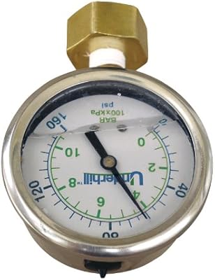

I used to lose 1 or 2 a year to freezing overnight in the truck. Then I bought the unit below in April 2014. Haven’t had a problem since. Works great and no issues. Currently $25.32 on Amazon Prime.
Cheeeeeep - “functions as intended” :slight_smile:
9 months & still AOK.

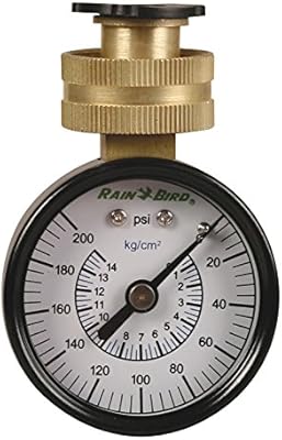

Rain Bird Irrigation water pressure gauge available at Home Depot for about $10. Lasts quite a long time as long as it doesn’t freeze. I also flush the hose bib for a short time prior to attachment.
I like the bleeder valve to keep from spraying water on yourself when taking the gauge off the bib.
