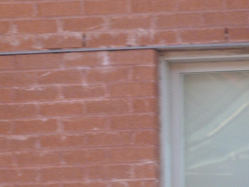

Weep hole location above windows
I normally see weep holes in the 1st row of brick veneer above windows. This house had them 5 rows up. This seems to defeat the purpose, but I haven’t been able to find a reference to required weep locations.
Nothing strange. concrete construction.
The windows are below a brick shelf.
The engineers architectural design calls for bricks to go so many courses (30) high before a another brick shelf is tied in to carry the next field of brick weight.
NOTE: Serpentine cracking though.
Note it. Recommend evaluation or pointing. I can not see enough.
The angle iron should be flashed and the weep holes will allow the wall to breathe any moisture out.

I may be getting ahead of myself. They may also be vent holes.
The window have lintels. All look good to me.
Metal expands contracts and is under load. In Montreal there is little masonry at the brick shelf. The shelf course is bitumen sheet with masonry pointed weather joint. The weather joint is filled with polyethylene caulk colored and 5/8’ thick to look like the masonry bedding.
Masonry bedding alone on a metal/steel brick shelf like the one in your photos have a tendency to crack laterally and wonder vertically.

That is not masonry veneer. That is stone veneer. The year of the building construction will also effect if it needs venting.

Incorrectly placed weeps. They should be above the lintel and flashed. There is no visible flashing where they are now. Of course, now it can’t be easily fixed. Just make them aware.

I agree with Joe! If there was a visible flashing then it would be OK. No flashing no go.
No flashing was visible, and I showed the buyer while on site but I just wanted to make sure. Thanks for the info. House built in 1989, brick veneer.
PS. A lintel is not flashing. Without flashing, lintels will rust out.
**no it wouldn’t be ok **
the required weep holes and flashing above the window/shelf angle are not present as depicted in the op pic
I don’t think you are understanding what I mean Barry. You still need weep holes at the lintel and it is better to have a flashing however you are allowed to have a weep holes anywhere you want as long as the flashing is below it. I did not say that it is correct because it clearly is not in this picture.
Not OK for having no weep holes above the lintel but Ok to have weeps at another location also.

Not enough information in the photo. Sorry.

The flashing, when there is one at the lintel, can be and most likely is polyethylene 6 ml. that is cut before the iron and under the masonry.
Flashing and capillary breaks are applied on brick shelf’s that tie into wall openings if the building is commercial or large residential.
I have never seen flashing on lintels on residential 1 and 2 unit building in my 35 years. I rarely see weep holes under windows or on the foundation shelf but will say that are gaining prominence seeing that homes are becoming more air tight.
Again it is dependent upon the engineered design of the wall.
NOTE The flashing is under the masonry. If it is poly plastic is cut at the metal edge and you will rarely see it. I have never seen metal and I am starting to see blue skin on metal shelf’s on concrete stacked condo’s and plastic (blue skin with weep holes on foundation. But again only small or large commercial…
