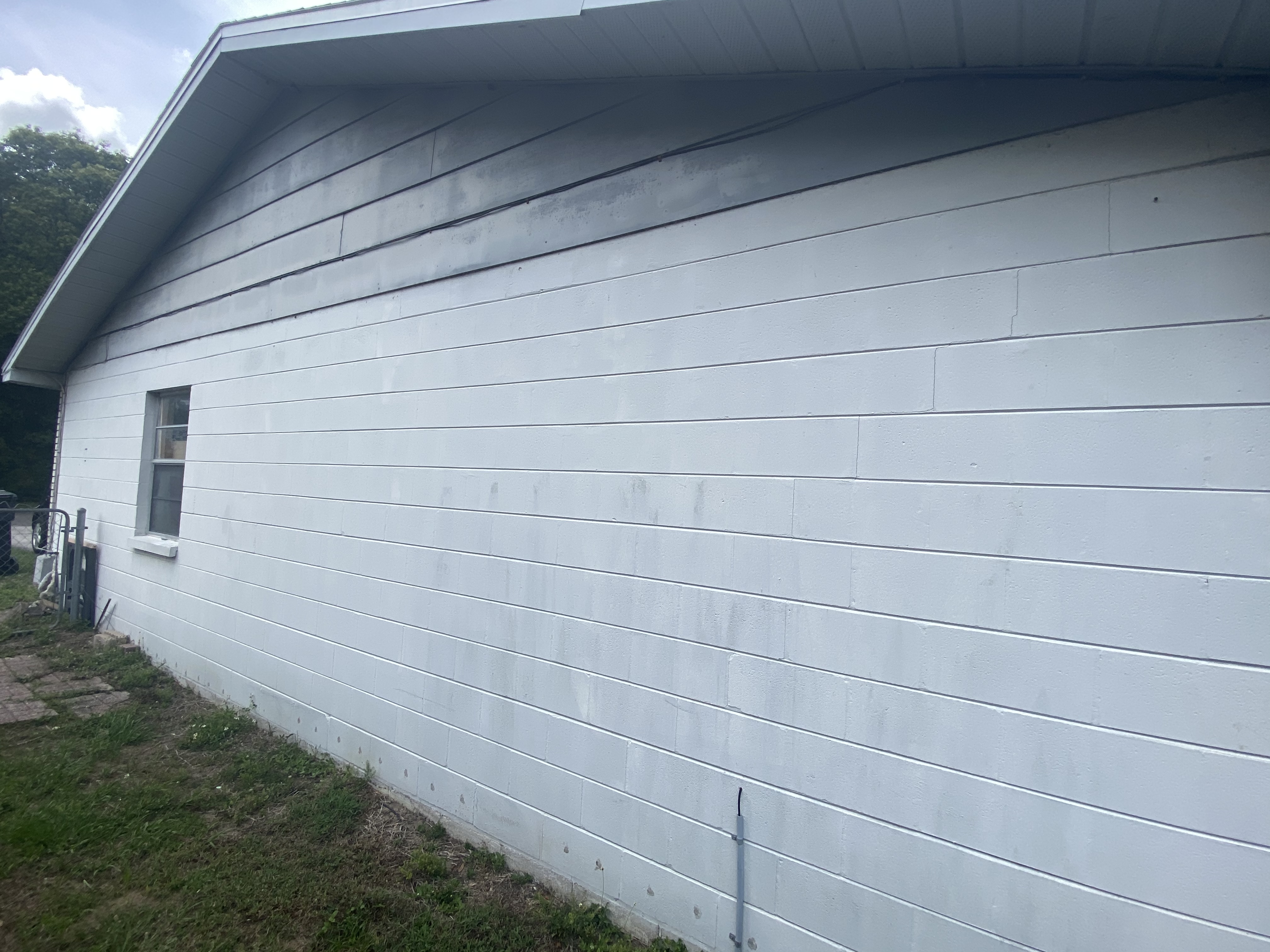

What can this be from?

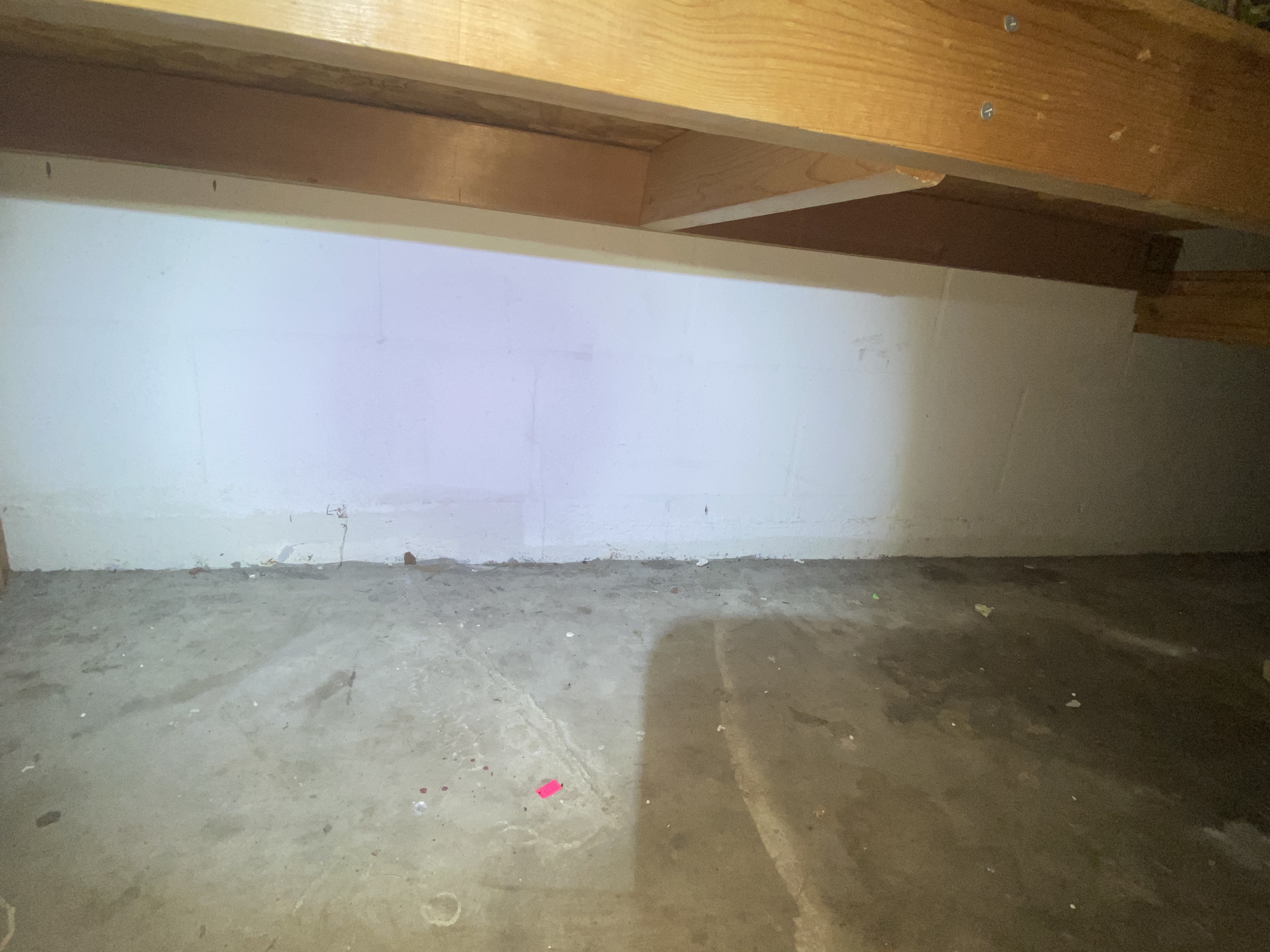

Does anyone have any idea what this can be? Home is from 1978 slab on grade foundation. These were only visible on one exterior wall, and they were on the bottom row of CMU. That exterior wall corresponds to where the garage is. And as you can see from the pictures nothing visible on the interior portion of the wall.
image|666x500
First thought is termite treatment through the exterior of the CMU.
Subterranean termite treatment.
If you take a close look there are 2 holes per block.
After drilling, you insert a rubber tipped rod, push hard to make a seal & insert approx 1-2 gal per hole @ 30 psi… Give it a “5 count”. Can’t see if the the holes were drilled on a small angle towards the ground - if the operator knew what he was doing.
You don’t want to drill the mortar. It would be a dead hole & splash back at you.
The purpose is to create a continuous chemical barrier between the soil & structure, thereby preventing subs to continue entering. :cowboy_hat_face:

Yes that is my thinking also.

I’ve owned 4 houses, all had termites. I looked at pic before I read the post and already thought “termites”.

I was called to a home once for an “evaluation”.
Didn’t understand until I arrived.
The slab was a monolithic, not floating.
You must trench under the slab to insert the treatment rods into the soil.
The dummy drilled holes & treated. A small problem… … …
He drilled thru alright, right into the walls & rooms above slab.
BIG lawsuit, severe contamination.
The OP pics denote was a floating slab & drilled under the floor/slab line.
If they had any class they would have used white cement so the patches won’t stand out like a sore thumb.
Doesn’t look that way in those pics. Looks like they drilled the first course of CMU, on top of the slab.

In one photo it clearly indicates a percentage the foundation slab above grade, with the first course of CMU block, that have been drilled and sealed. I thought, and it might be incorrect, if this was treatment for subterranean termites, I thought soil treatment would be an appropriate treatment on the surrounding soil, ‘to act as a treatment barrier.’ But then again I must admit, I am not qualified nor an I a licensed termite treatment contractor.
Drill holes, 2 per CMU, in first CMU course Slab above grade
