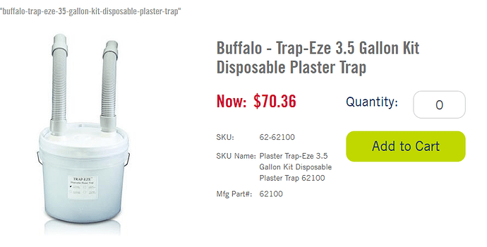

Looks like you found a clay trap - common to find in pottery studios to keep clay from clogging up the drains and out of the wastewater system. The bucket is to catch sediment, which you can clean out and sometimes reuse.
Agreed. I have seen similar in medical clinics and dental offices. aka Plaster Trap.
example
Looks like we have a ‘winner’. Now, seems like there should be a P-Trap down stream from this for sewer gas. :man_shrugging: ?
I believe it remains full of water with sediment dropping to the bottom and clear flowing off the top. (septic tank theory).
This all makes sense now. Thanks for the help. This was a former dentist office and based on the replied received here, Im assuming when they did the plaster mouth casts, they would rinse things off in this sink. Thanks everyone.
