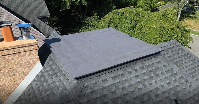

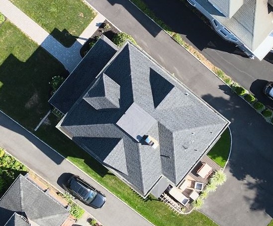

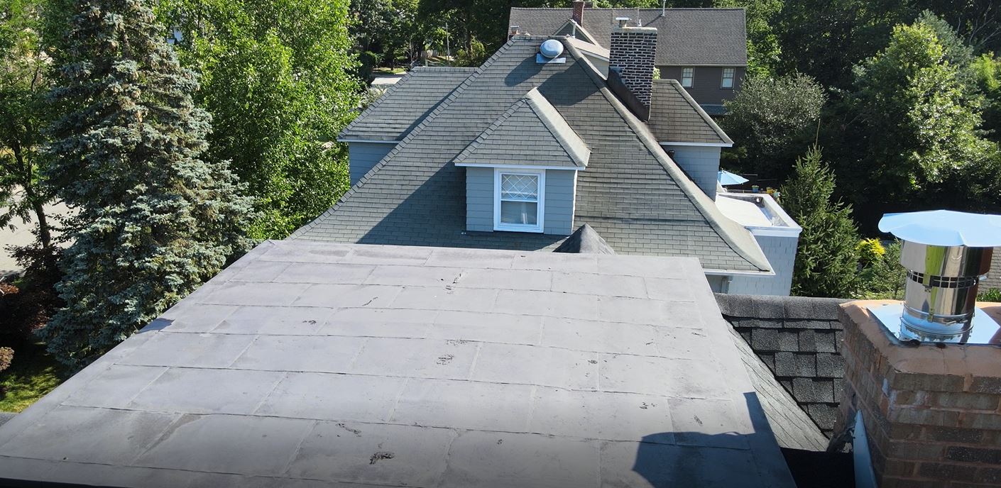

I inspected a 120 year old house yesterday. The majority of the roof was covered in new asphalt shingles, there was a flat roof covered in rolled roofing, and at the top of the house was a flat roof that I need help identifying. I’m not sure if this flat roof was done a few years ago with the rest of the house or if its older. Thanks for the help.
Just a guess, It looks like a soldered tin or copper roof?
I assume that you didn’t get up on it to feel the surface. Just from the pics, though I’ve never seen one, I tend to agree with Scott. The only other idea I have would be some kind of torch down but that doesn’t usually get applied in chunks like that.

No James, I couldn’t get anywhere near the roof. All pics are from drone.
Scott, that’s seems like a possibility!

@sbridges2 Thanks for posting that Scott! I was not familiar with that roof style.
Good article, but that’s not what that is.
Google “Widows Walk”.
Although originally found only on the coast, the “Style” is also used inland, not just on the coast. Very common on Century Homes, and as time passes and leaks occur and constantly need repair, the original hatch with ladder access (or small staircase) are closed off and typically covered over with EPDM or now PVC. If closed off decades ago, you may see the tin (sometimes painted) or even copper panels.

Interesting suggestion that it could be a widows walk. I haven’t ever seen one in these parts but I suppose it is possible.

Did you at least inspect this area of the roof from the attic? Got pics? Often the framing will reveal information of it’s history.
Northern NJ. The attic was not accessible- finished ceiling throughout the 3rd floor.
