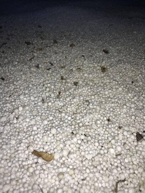

What type attic insulation is this?
This stuff looks like popcorn shipping foam, small little pellets of Styrofoam type material, I have never seen this before (house built in 1940) Anybody ever seen this before in the attic ?IMG_1596

Looks like PERLITE.
They still using that Scott?
Expanded perlite, not the crushed stuff.
And OP’s picture here;
Expanded Perlite.

The “other” white insulation, but I have to agree with @mcyr…
You can read up on it here;
https://www.perlite.org/insulation/#:~:text=Perlite%20insulation%20is%20an%20inorganic,pizza%20ovens%20and%20rocket%20stoves.
about 2.7 per inch
Perlite , including perlite building Insulation is a non-fibrous non-asbestos-containing material which has an R - value of about 2.7 per inch and would not be expected to contain asbestos.
We used to dump that stuff into block walls that didn’t have grouted cells for insulation. It’s super light and mimics styrofoam beads. If the wind was blowing it made a mess. LOL.
