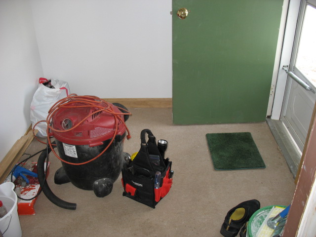

Mudroom recently attached to, 1970’s house relocated to this spot 2 years ago.
The mudroom has just been “completed”, it is built on posts and open air below. Anyway, there is no lite inside the room, no outlets and no heat. If this is considered non-living space, are outlets required?
From my codey code standpoint, no, no electric is required.

I say “yes” based on the fact that, although the room is not habitable, it is a part of the “dwelling unit”. Receptacle outlets shall be provided for all wall space within the dwelling unit except individual isolated sections “that are less than 2 feet in width”. Heat and light have no bearing on this.
In order to vacuum this area, or to provide temporary light or heat, the lack of a receptacle outlet is going to necessitate the use of the extension cord, which the code does its best to minimize.
Within a dwelling unit, it is not the habitable space but the “wall space” that dictates the need for receptacle outlets. Even the fixed section of a sliding glass door assembly counts as wall space in configuring the need for an outlet.
In NYS, the “conditioned” or “unconditioned” has bearing here. Being an unconditioned space, it most likely would not need a receptacle. Treating this very similar as a porch would be treated.
Being part of the means of egress, it would most likely need a light though. Switching of this light can be from the inside of the dwelling.

One of the intents of the spacing of receptacle outlets in a dwelling unit is to reduce the use of extension cords. This is an area within a dwelling unit with walls greater than two feet in width. There are no other considerations that would bar the use or placement of a receptacle in this area while there are provisions to require it.
By the code, it requires receptacle outlets.
This is not an interpretation that requires an extensive work history or knowledge of the fundamentals of electricity…but simply a willingness to support the code’s intent to provide adequate access to receptacle outlets throughout the dwelling unit, as prescribed.
