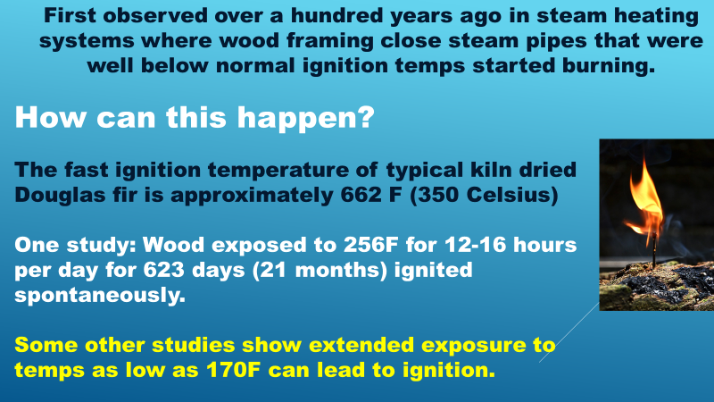

Why check water heater flue pipe requirements?
A few pictures says it all.

What was the appliance served? single/double wall?
Water heater single walled aluminum pipe all the way from the water heater in the basement up through a hidden chase and up through the roof. It was non-compliant from the water heater to the termination point on the roof.

What initiated the event pictured?
Combustion !
6" to 36" depending on the equipment. This was a fire waiting to happen, and it did.
These are from a PP presentation that I occasionally do…

And none of these clearances require actual empty space, which lets attic smells into the living space.
A non-combustible collar can be used to air seal the annular space.
