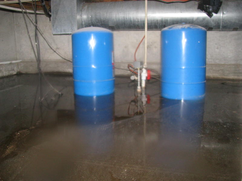

You mean it started to drain when when you popped the cover?! That’s some serious infiltration.
In the first photo … the water is flowing from the entrance.
It’s times like those when frantic scrambling for a camera typically occurs. ![]()
well, at least you knew the seal and weatherstripping on the access panel was in good shape.
