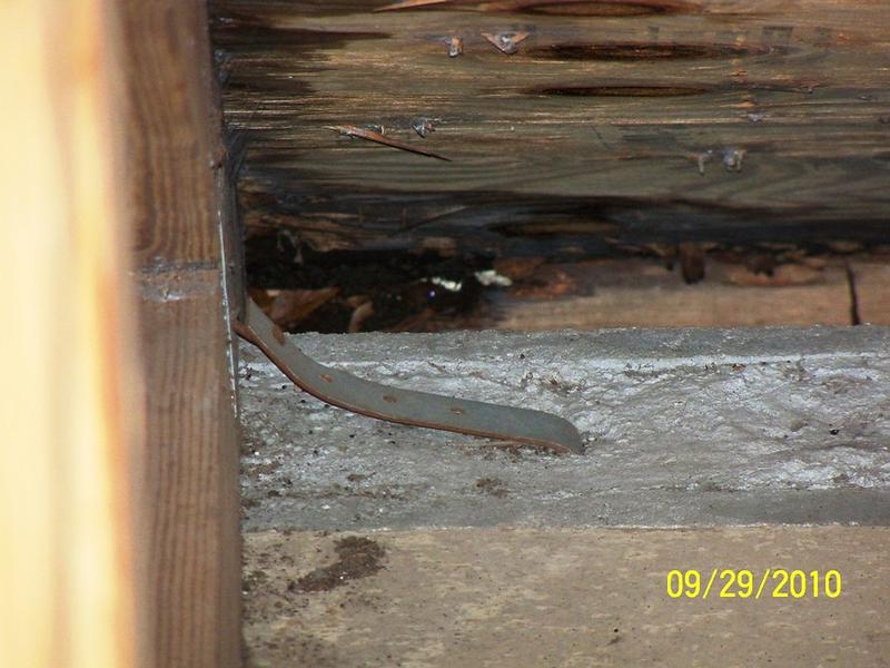

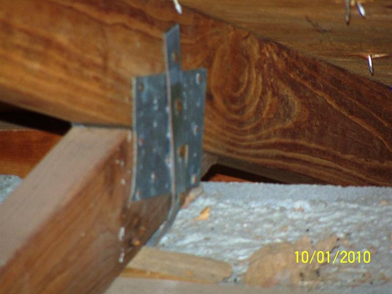

Yet another example of construction creativity: Photos depict strap embedded in the wall to the left of the truss, runs UNDER the truss and then up and attached to the right side. What say ye - Clip or not Clip?

clip
clip - it dosen’t go over the top and get nailed on the other side. Seriously it may be weaker than a clip! and proper blocking would have made it OK.
it is likely weaker than a proper clip. I am going by the definition of the form.
as should we all
I get the clip, But I questioned the application. If the clip (or strap) is installed improperly (say too far away from the truss) it would tend to act as a hinge and I would say Other: Improperly installed clips. Does this not result in the same fault?
I would have to select other. Then explain that the strap is embedded into the concrete more than a 1/4 inch from the truss and that it runs under and up over the truss.
Technically this set up is just as weak as a toe nail.
My opinion is… is any of your valid points actually on the form? No, Not in my opinion.
I only try to answer the questions as they are on the form. Good Luck.
It is my opinion that it meets the clip requirement as per the form you are signing. That does not mean it is correct it only means that it is what the form says.
I agree with Greg…‘other’ with photo & explanation.
I would say it meets the definition of a clip on the form. Include a picture and let them deal with it.
This exactly why we state approved training material with field examples. Yorks’ training, pgs 118/119 clearly (IMO) calls for improperly installed straps to be reported as ‘other’ with explanation due to unblocked space and not being installed straight up and down to properly transfer load. I understand that his course is not approved by the state of Florida yet, but it would be considered a valid industry reference, as would the InterNACHI training.
Even without the training material reference, calling this a clip because it meets the definition of 'metal attachments on every rafter/truss…'is, again IMO pretty weak. Imagine the Rube Goldberg contraptions that could fall under this same logic.

I agree they are installed incorrectly and will not hold as if they were. I do believe that the have a much greater uplift than toe nails though.
The problem with allowing them( the agent, CSR or underwriter) deal with is they do not know how to. They will rate them the same as Toe nails and move on.
Almost every home that has straps has several that are not installed within 1/4 inch. I almost never see proper blocking either. Since we are going by the weakest connection, no home in the eighties or early nineties should get any credit based on improperly installed straps. You have to go by what the form states, without further authorized guidelines we have no choice. IMO you would be covered if you reference York’s guidelines or quoted the form. Erroring in favor of the insurance companies is in some peoples best interest.

Thanks for the input folks - For your information - I have gone with Other: Improperly installed clips.
My reasoning is two-fold - 1. The truss is subject to movement 2. Don’t want to give false sense of security (be it the insurer or the insured).
I try to look at the intention of the question - Will the truss shift or move? If I was the insured or insurer would I want to know of a condition exists that would not provide the protection that the device is intended to provide.
