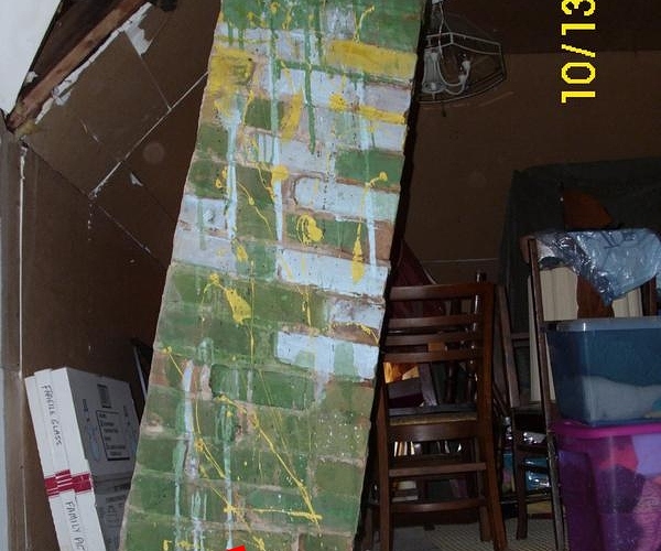

Witches Bend in Chimney
Good reference work Mr.Jonas.
I am looking for a chimney as the one that was being discussed.
A free standing chimney with that much deviation or lean.
Not locked or bonded into a wall that was built to aid in its weight distribution.
If you find such-an example please post it to me , email it to me.
I would like to understand why it was built that way.
I have rebuilt chimneys like that and had photo,s.

Chimneys leaning on the portion above the roof.
http://www.buildingconservation.com/articles/services/chimney.htm
[size=3]LEANING CHIMNEYS[/size]
A combination of erosion, acid attack and salt crystallisation are liable to cause a chimney to lean (see illustration). The BRE Good Repair Guide says any chimney that leans more than 1mm in 100mm is unsafe. This is perhaps a little too cautious and where historic buildings are concerned, one may wish to apply the middle third rule to the shaft wall around the flue. Thus where the shaft wall is half a brick thick, a lean of 35mm could be tolerated, but if in any doubt, consult a structural engineer.
Where repairs are impossible, the remedy of last resort is to rebuild the stack from some convenient point - say the top section only or completely from below roof level - using as much salvaged material as possible. To comply with The Building Regulations any rebuilt section will have to have an internal diameter of 200mm (although 185mm is acceptable for a relined flue), so some ingenuity may be required to incorporate a flue liner within the original stack dimensions.
If it is decided that the existing lean on a stack can be tolerated the factors inducing the lean should be stabilised. The flue should be lined (see Parging Failure below, and broken or decayed bricks should be cut out and replaced. In slender stacks it is a wise precaution not to take out too many bricks at a time (sometimes no more than one at a time) and the new mortar must be allowed sufficient time to achieve strength before proceeding with the next area of cutting out. Cracks should be repointed and all ‘defective’ mortar raked out and repointed.
‘Defective’ mortar may be taken to include that which is loose, crumbling or cracked. As a general principle (and this applies to all repointing, not just on chimneys) if a lime mortar is difficult to remove, repointing is not necessary. Any hard cement mortar will be more difficult to remove. Take care not to damage the edges of the brick or stone. Rake out to a depth of 25mm or twice the width of the joint whichever is the greater; do not rake out deeper than 35mm. The strength and lime content of the mortar will depend on the hardness of the brick or stone, in accordance with usual good practice for repointing. If it is necessary to add some cement to the mix, use sulphate-resisting cement. Similar mixes will be used for rebuilding stacks.
Once a leaning stack has been stabilised, some periodic checking (for example during quinquennial inspections) is advisable.
Chimneys on the interior have been built every which way but loose in the past.
Flues or no flues, it did not matter.
Slight bends in a chimney on the way up to the roof never affected a thing regarding draft or draw or build up of creosote as long as there was not shelf inside the chimney to help accummulate the stuff.
I have seen more crooked chimneys in my life than I can throw a stick at.
Had one in 1989 built by our own mason on a weekend, and when I walked the second floor of the school and looked out the window, I could see two corners of the chimney. Might have been plumb, but had a 2" twist from the roof to the top.
I had him take it down and start over.
The guy was an excellent Mason too. Sh$t happens. He never stood back a few feet to look at his work.
I have a picture of crooked chimney in the attic, but is on file on a disc somewhere. I would have to dig it up. It had flues in it too.
Unlike what was said, I have never seen a chimney that was!!! Plumb.

The image you posted is quite typical of a defective chimney from deteriorated mortar as stated above. Here’s one I did a few months ago…
But the chimney in the attic (in post#1) was purposely installed with an integrated lean. I see these a lot in older homes. I have to go with the belief that the mason purposely brought the chimney away from the ridge line of the roof.

A crooked fireplace chimney.
Inside a 25 year old crooked chimney. Wow, the crooks sure did not contribute to much to creosote.:slight_smile:

The main point I was making was that the 132 year old section of angled brick chimney was built by design, and other than normal wear and tear, was not falling or pulling the roof or house over, as someone else indicated was the case if it was not plumb.
Nice Pic’s Marcel!
Thanks Jeff. Thought it was fitting for this thread. Took me a while to find them. :wink:
And you are right, a crooked built chimney does not pull a structure roof or anything else around it.
It just stays crooked unless it exceeds the center of gravity from the centerline. :mrgreen:
I guess the bottom line is that an out of plumb built chimney is just an aesthetic issue more than structural.
They still work as intended by design of the flue size and the height.
