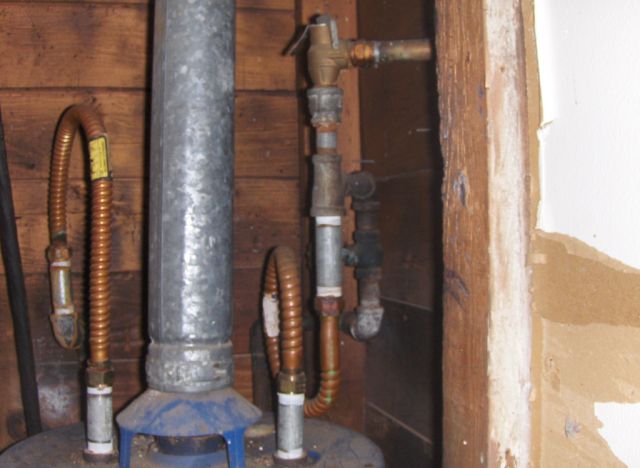

Seems that it took a lot more thought and energy than simply doing it right.
wdecker
(William Decker, CMI, IL. Lic. 450.002240)
May 11, 2009, 1:10am
6
Seems that may DIYs, as well as many plumbers, seem unclear on the point.
The TPR valve does not drain water. If it goes, LIVE STEAM will come out.
But, thinking it will merely drain water, they treat the dischage as if it will be water.
Just like the big bathrooms, with a shower and separate tub and steamer and all that, but the only vent fan is in the separate toilet room.
Then they wonder why the have mold.
Hey, I didn’t want to kill the deal so I didn’t write it up. :mrgreen:

Hey, Joe. That’s very similar to my best. There’s no sense in wasting any water.
jhugenroth
(Joe Hugenroth)
May 11, 2009, 6:14am
10
Russel, I like yours better.
Mine doesn’t have a water softener recycling system. :mrgreen:

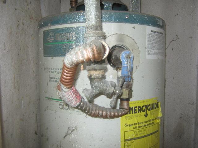

Here’s one to consider for 3rd place (yes, that is the cold supply):

I’m confused…
(emphasis mine)
wdecker:
The TPR valve does not drain water. If it goes, LIVE STEAM will come out .
http://www.nachi.org/tpr-valves-discharge-piping.htm
TPR (temperature pressure relief) valves are safety devices installed on water heating appliances such as boilers and domestic water supply heaters. TPRs are designed to automatically release water in the event that pressure or temperature in the water tank exceeds safe levels …
The valve should be connected to a discharge pipe (also called a drain line) that runs down the length of the water heater tank. This pipe is responsible for routing hot water released from the TPR to a proper discharge location.
Anyone else?
mlarson
(Michael Larson, WI Lic. # 1672-106)
May 22, 2009, 2:59pm
15
Will misspoke IMHO.
Steam might possible under very unusual conditions but TPRs they are designed to open at 210 deg. F and/or 150 P.S.I.
mlarson
May 22, 2009, 11:04pm
17
Maybe my head has gone soft Brian.:shock:
Are you trying to tell me that the H2O temp would go up as it leaves the TPR and goes from 150 P.S.I. to 0 P.S.I.?
Hint: Compressibility of water
kbraun
(Keith Braun)
May 22, 2009, 11:21pm
18
Believe it or don’t: One end of garden hose attached to sump pump discharge; Other end of garden hose clamped to TPR drain line. Turns out the elderly gentleman had gone slightly senile before admittance to the nursing home.
bkelly2
(Brian Kelly, AZ Cert. # 60234)
May 23, 2009, 12:44am
19
mlarson:
Just the opposite Michael, I was agreeing with your assessment that steam would be hard to produce in a standard, functional water heater.
