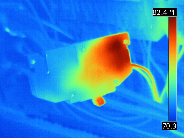

Interesting, I have inspected many Zinsco panels and have found several with scorched bus bars.
want pictures David?
Gerry
I’ve replaced breakers on those many moons ago. Like Gerry said, many are scorched, brittle and falling apart and at the same time they look OK on the surface…

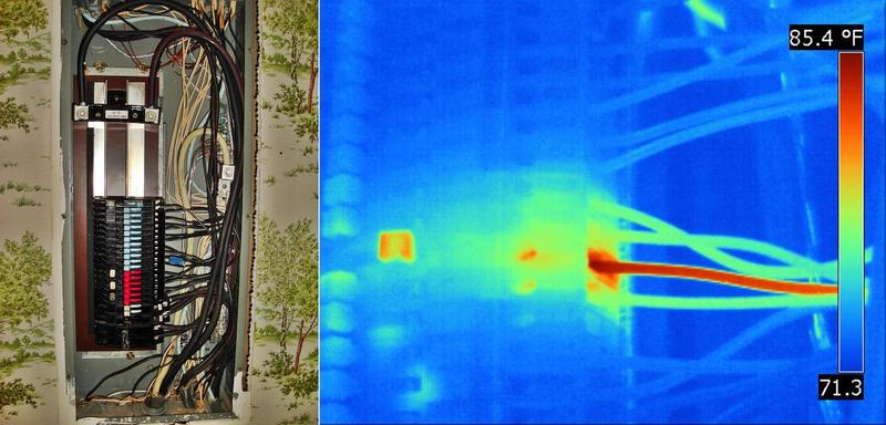

Here are mine…

Breaker removal (for inspection) is not needed unless there is a hot one.
Electrical arcing is several thousand degrees (at the source), all failing components generate heat when failing.
Any thermal evaluation is sufficient as a reason to recommend replacement.

You have an IR camera and are allegedly “certified”, you can’t tell a good from a bad breaker “At the time of the inspection”?
