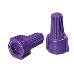

You could use either of these. I would prefer the ones with the set screw:
http://www.alcopstore.com/images/image0009.jpg
Those purple wire nuts sure are expensive.
