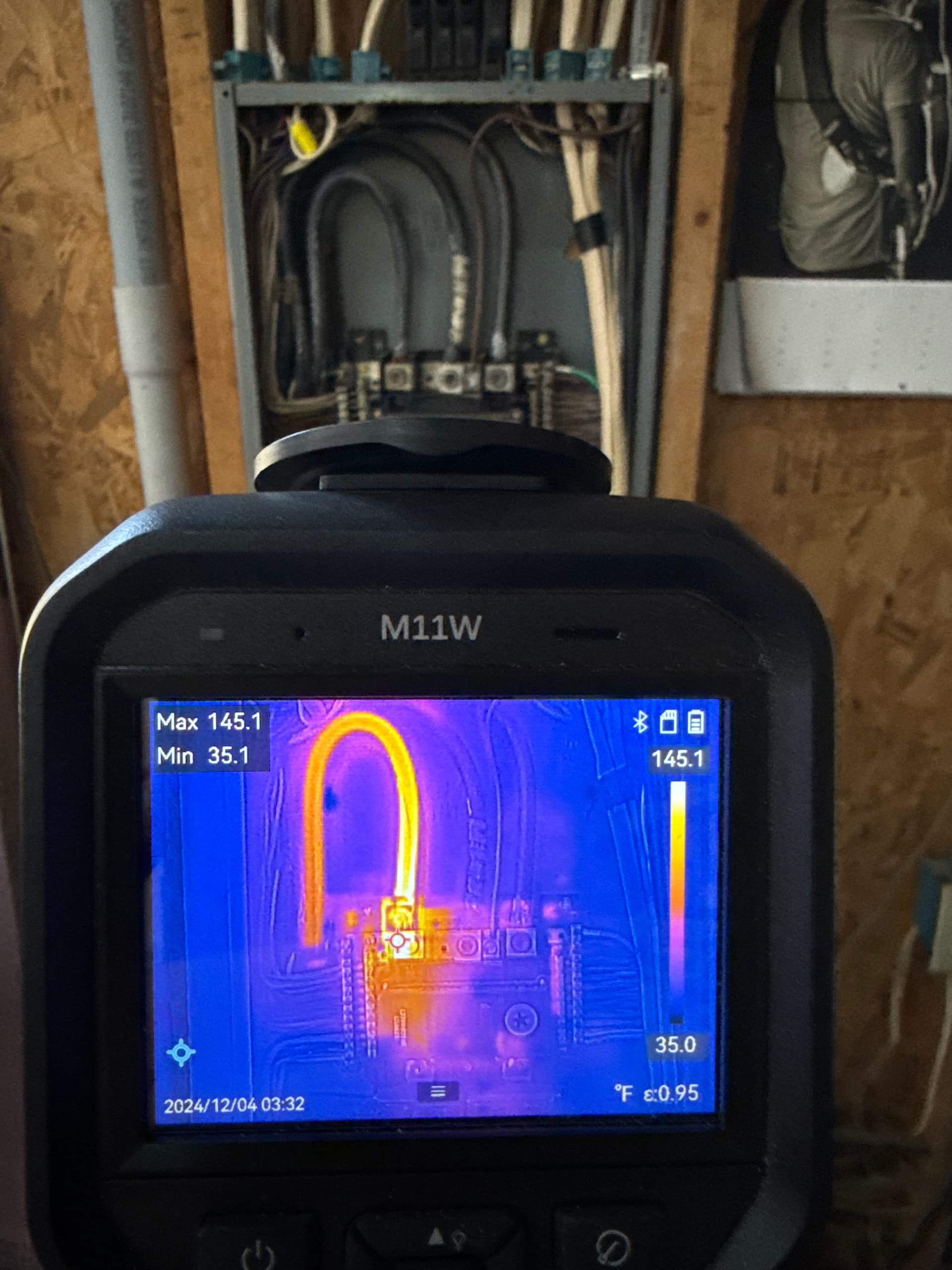

What’s the consensus on this picture from this morning?
The garage is not heated so the temperature inside was the same as outside, 35°F.
One of the service entry conductors was warmer than everything else. Especially at the lug.
I recommended further evaluation by an electrical contractor.
Yikes.
My guess is they have half a dozen space heaters on one leg. Sum up the amp draw on that leg.
That would reach my level of call an electrician because if nothing else, some of those loads could be swapped over to the other bar just by moving up or down one.
