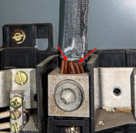

30 amp water heater breaker is hot
Do you have a photo of the terminals? If the issue were all of the load on one leg then the neutral would be carrying about the same amount of current and should have a similar temperature.

Look at the top curve of the neutral, it’s glowing too. I can’t tell, is there tape on the part near the lug or some kind of strain relief?
It’s hard to tell but if only the one leg were heavily loaded then the neutral would show near equal amount of heat. It appears that where it enters the lug the neutral is no warmer than the other leg to the right. What’s obvious to this type of question is that were merely guessing without knowing what was the amount of load on the conductors.
The load could be perfectly normal. An electrical flash is 5,000 to 20,000 degrees Farenheit. If the terminal lug is loose and arcing regularly, those tiny flashes will definitely heat it up depending upon the frequency. There seems to be no discoloration of the lug, so likely not getting much hotter than 145F. Good catch.

I agree it could be loose but one theory presented is that the one leg that is much hotter than the others had a lot more of the load. If that were the case then you would expect to see a higher temperature in the neutral.
The heat on the curve of the neutral is radiated or convected heat from the hot leg.
Would you also agree that the hottest point on the hot conductor appears to be at the terminal?
Yes, the hottest point was at the lug. The wire insulation was not melted. I put on a leather glove and i tugged on the wire gently and it did not seem loose. I didn’t over do it, I just checked that it wasn’t super loose, but it felt solid.

here are a few more pictures to answer some of the questions you guys asked.
the range setting was “automatic” and emissivity was set to .95

The lug connects to a small piece of bus that connects to the breaker so it is possible that the lug was properly tightened and not the cause of the problem.
Smart man! I was going to recommend getting closer because the spot size was questionable. Look what happened with a proper spot. There is an increase.
The nicks or cuts in the wires is also interesting. Possible temp increase due to resistance?
Nope, it has nothing to do with the load. It has to do with a loose connection, not necessarily at the, lug but behind the breaker.
The thermal pattern of the conductor and components is that of conduction heat transfer. If it were load, as most people perceive it as, everything would be the same temperature basically.
A gradient points to the direction to where the heat source originates.
