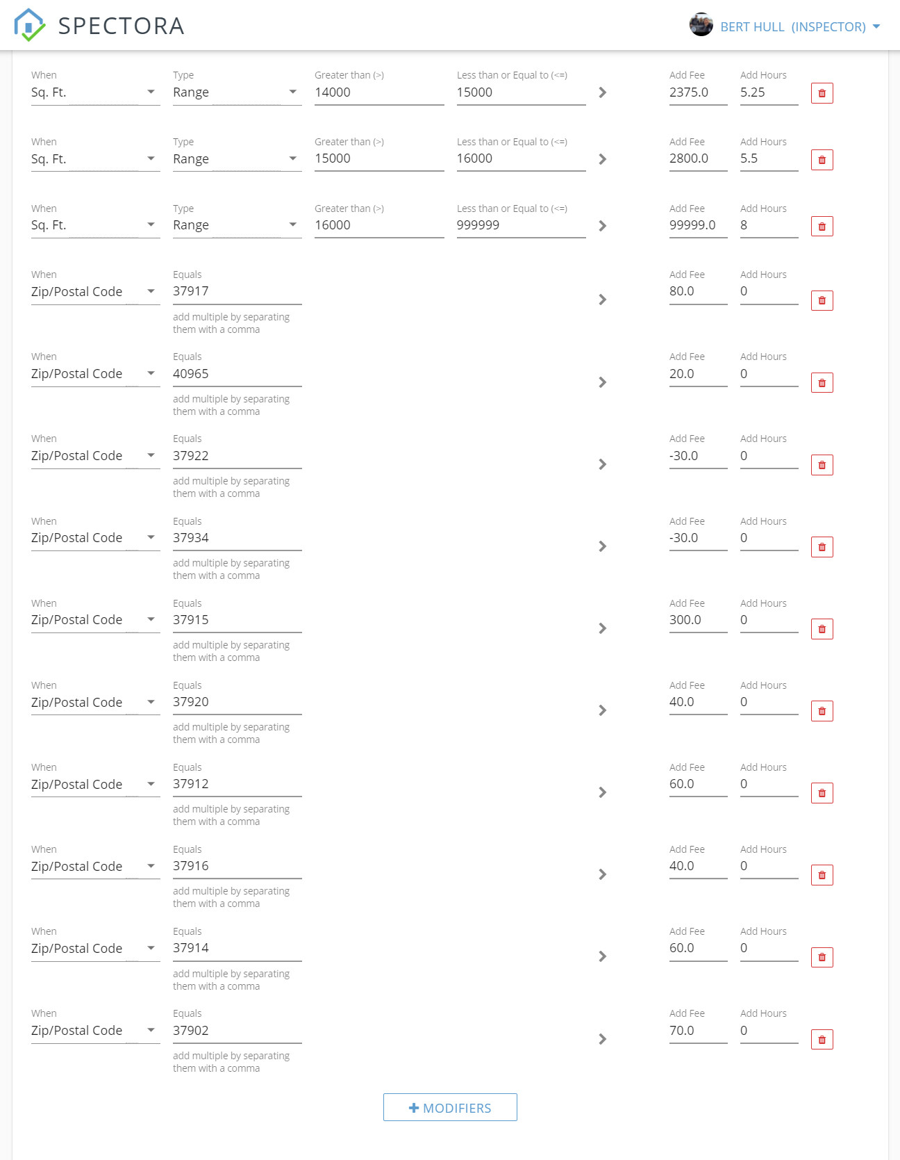

Here is my formula. What works for you might be different
Age
Distance
Occupied?
Foundation Type (Crawlspace)
Driving Distance
Size (ft²)
Zip Code (Price myself out of high crime areas)
Do you use that Spectora calculator?
Here in Atlanta, some miles are a lot harder than others because of traffic patterns. But, I know my city very well and can make adjustments instantly.
Yes, this is the Spectora calculator.
This is the formula used when I enter an address to schedule an inspection. Spectora pulls the data from the internet automatically from the address.
It also works when someone enters a request for quote on my website.
I like that Spectora is able to generate a cost automatically given my formula.
Here in East TN, we don’t get many traffic jams.
Do you have control of the formula? I see that you “price yourself out of high crime areas”
I can change it as often as I like. I don’t ever work 37915 but I often work my own Zip 37922.
$300 add for 37915. $30 discount in 37922.
