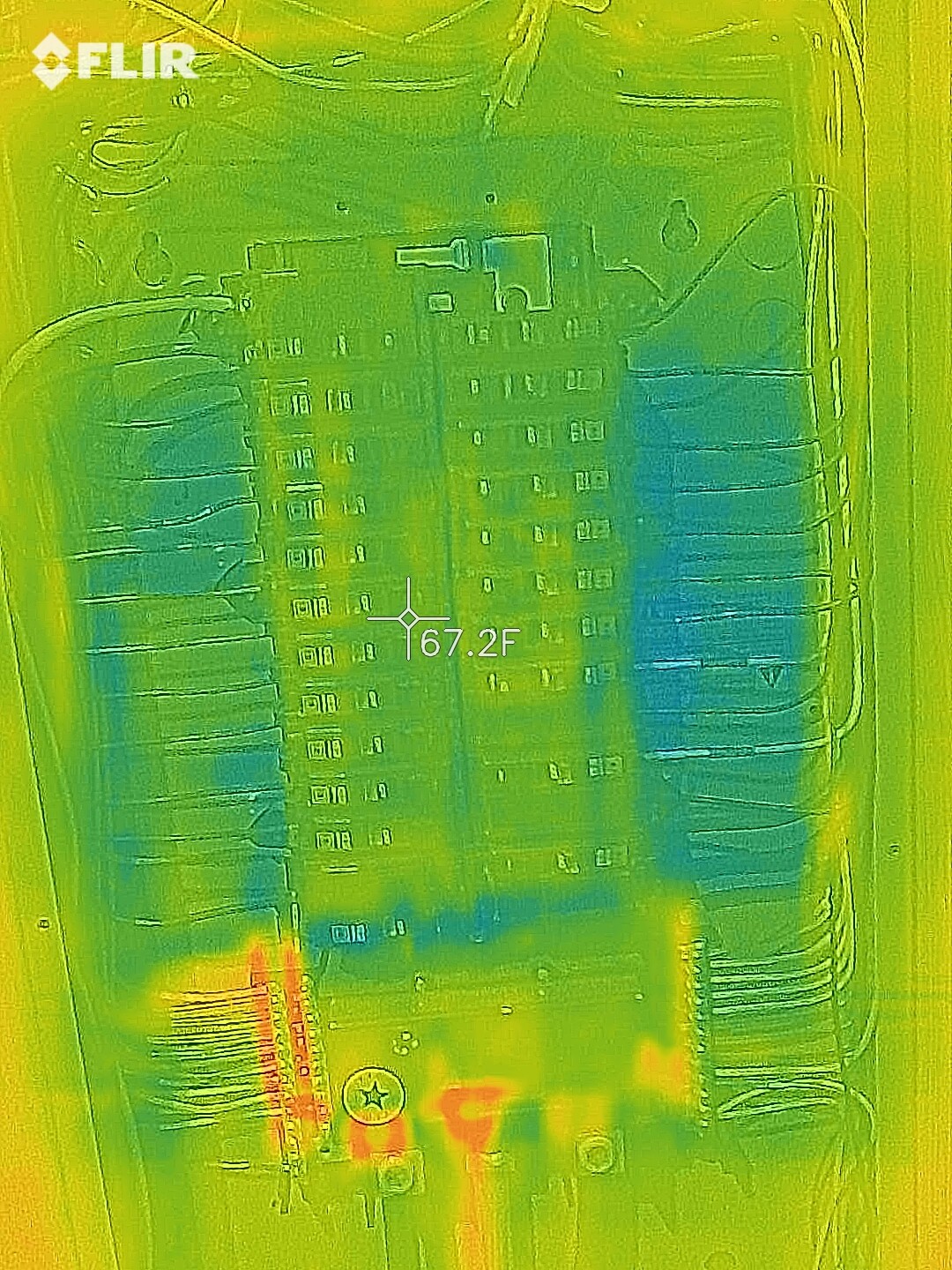

Aluminum Entrance Conductor - Neutral Issue?
Once again, taking advantage of the experienced minds here - Please spare me on making fun of my crap Flir One - I don’t have the big inspector money yet …
Does this photo indicate a loose termination at the neutral lug? I did not go hands-on (in hindsight I probably could have just gave a wiggle)
Randy, it could indicate that overheating but I don’t think 4.5 F between the breakers and the neutral termination is enough information to go on, especially in different pictures.
Best to you.
With such a low temperature differential a regular old photo might be better to analyze the neutral connection.
For future - what temperature differential would be of concern?
That could simply be a reflection since you are shooting bare aluminum lugs.

180X240 Ti300 60 Hz.
I did not remove the front nor did I load the circuit. I use to but no longer. I use to load equipment circuits for >< 15 minutes them take an image as well as measure load on the SEC.
The image panel fronts ambient average temperature is ><67.2° approximately. Max temp 72.6° Min.=63.4 in the bays outside the panel. Read the index below.
Look at the 3D image below. You can see the temperature spikes from the objects emitting heat.
You do not think heat radiating from a loose SEC termination on the hot lug would not show up? Hm…
