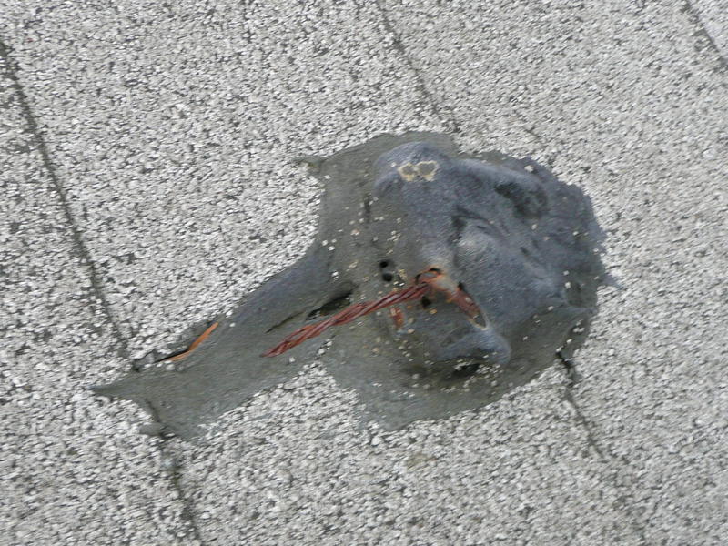

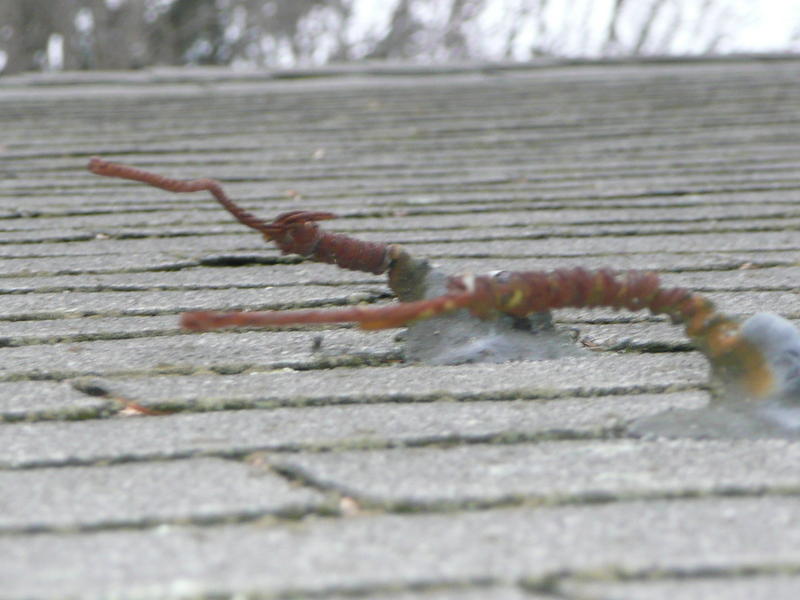

Are these old attachments?
(Terrill Ewald, CPI, MD# 31310) #1
Does this look like old antenna support attachments? There were 3 on the front and 2 on the back roof.
(Robin Wells) #2
Look like they could be old guy wire attachment points. Was there any evidence of any structure they were attached to.. they should all point towards a common focal point if they were for guy wires.
(Terrill Ewald, CPI, MD# 31310) #3
No, home built in 1960
(Roy D. Cooke, Sr) #4
That many attachment tells me he was likely a ham radio operator
