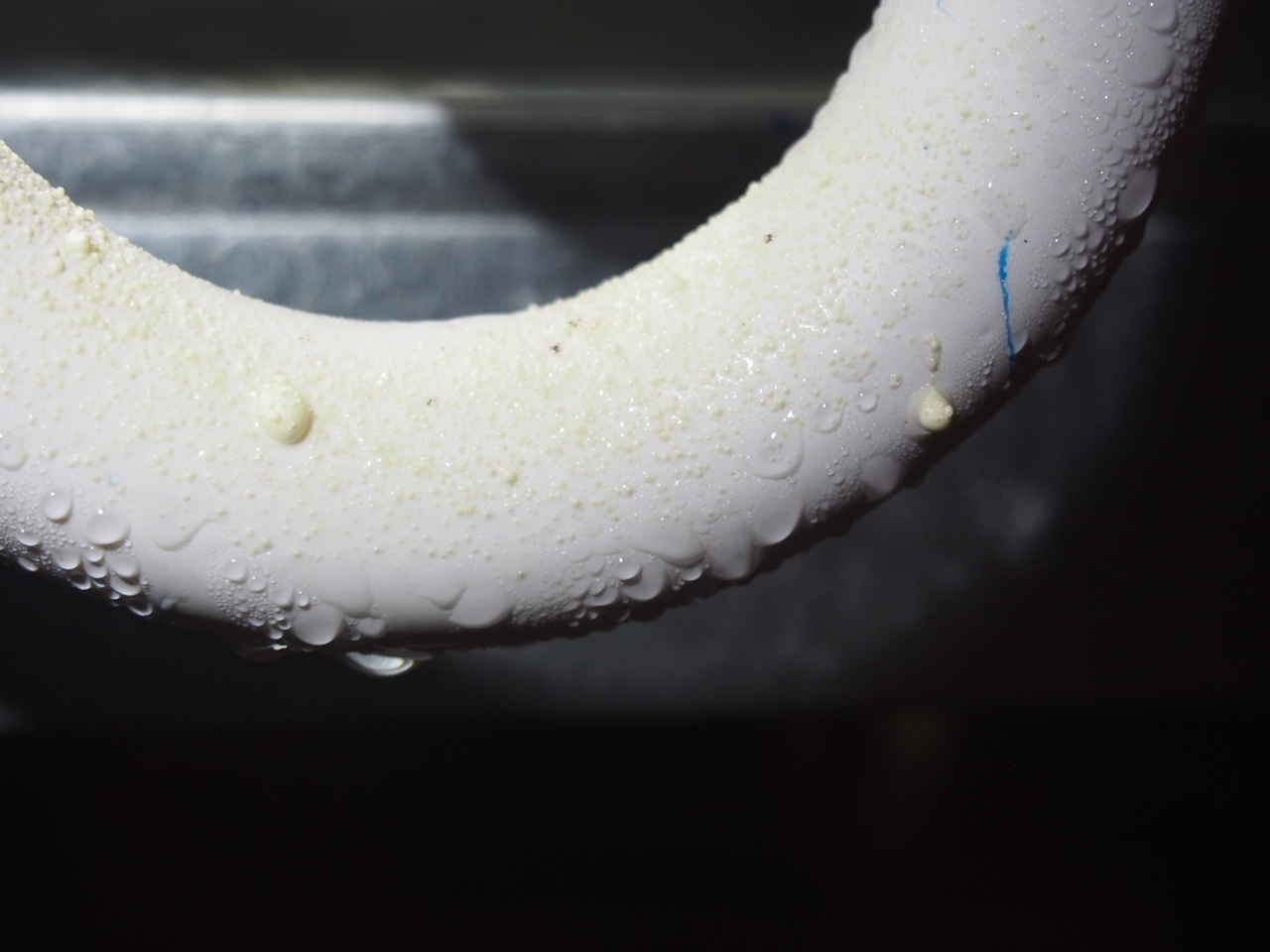

Here in N.Texas we call out the primary condensate p-trap if it is not insulated. The reason is and I can show you pictures to back it up. The cold primary condensate line (ironically) condensates due to the high heat and humidity in the attic and drips.
