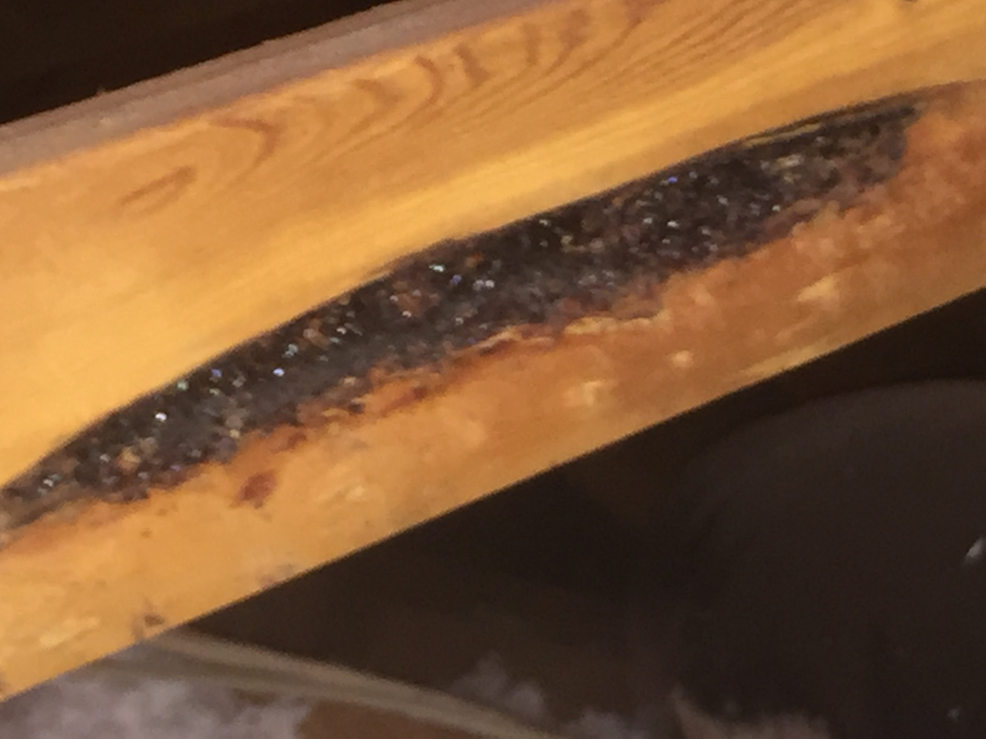

I found this on an attic truss? Is it some type of larvae, Insect nest, or something that else? I found his
From MI, it looks like wood wane with pine sap in it. Not an issue. IMHO.
Best to you.
Thank you! Any concerns with the integrity of the truss?
I agree with larry. Not concerned with the truss unless other signs of failure are present (cracks, loose fasteners). The wane technically means less wood but from your pics it doesn’t look like a structural failure is present.
