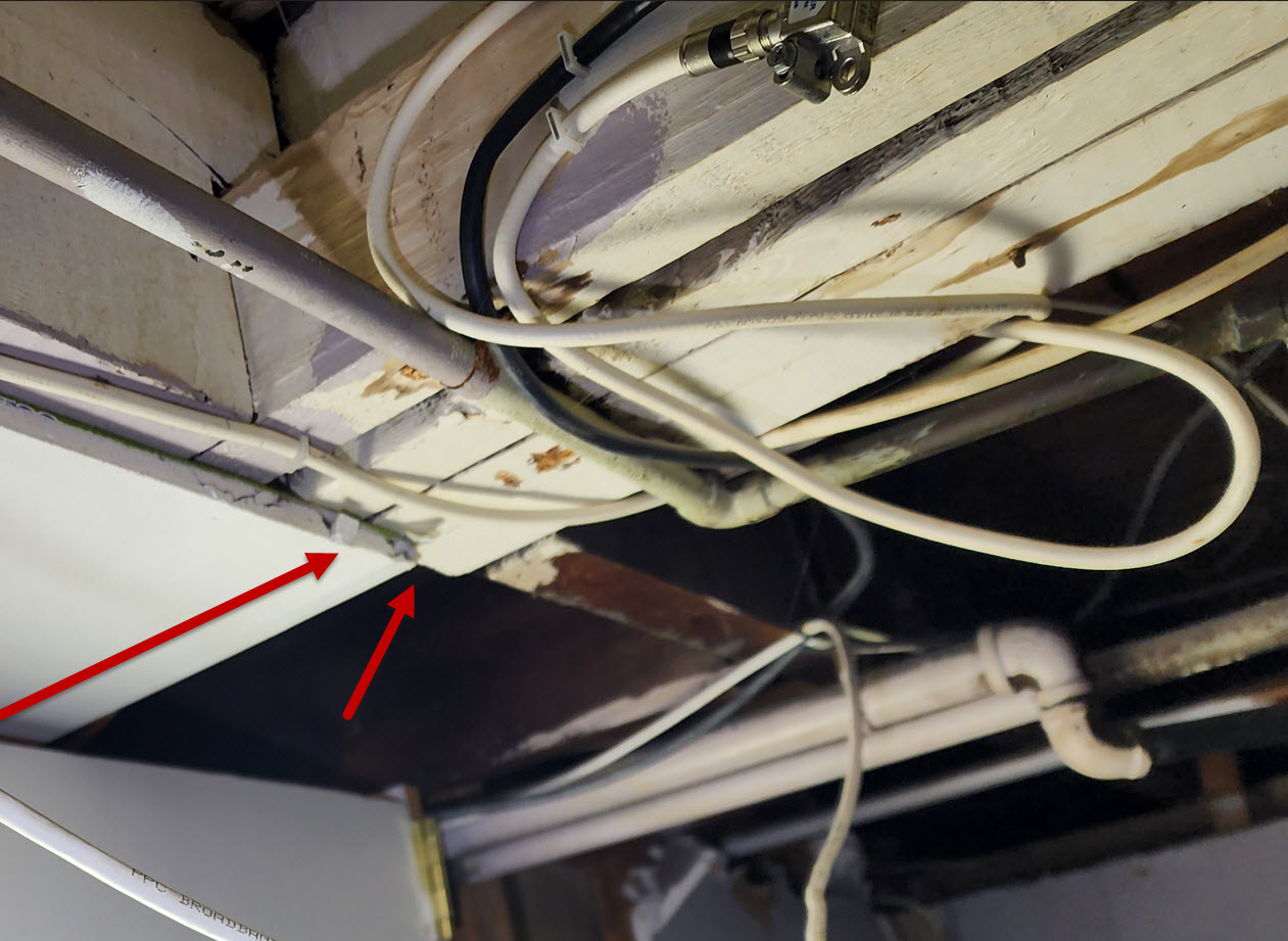

Basement Girder Not Continuous/Has a +/-40" break
Hi all- looking for some experienced inspectors to share your thoughts.
I did an inspection on 95yr old house.
Main girder was not continuous> about 3-4ft break in it.
Cuts on girder look old/same color as 95yr old lumber
someone added some 2x bracing and plywood>>>obviously added later
I thought may have been a closed up stair but the location does not make sense. Any ideas?
Maybe an old floor furnace was in the space?
Thanks- not sure but its not boiler now…no central a/c

Anyone’s guess I suppose. Floor furnace, hatch, steps etc. It appears they framed up the old opening/floor with some undersized materials.

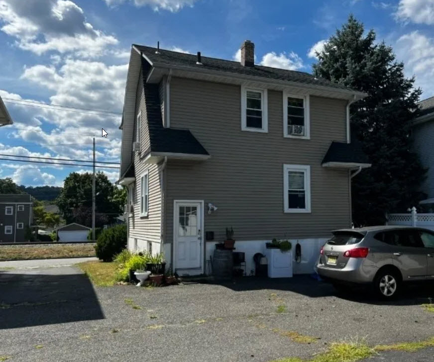

IMO… that floorplan is not typical of a 1920’s home.
What style home is it? What are the size/dimensions of the rooms?
Got a pic of the overall exterior elevation? I suspect that staircase was relocated or removed.
3 pics
  1. Front of house with common driveway to rt
  2. Front with drive to left of house
  3. Rear

  1. Section that is cut out/plywood repair is 30"x30"
