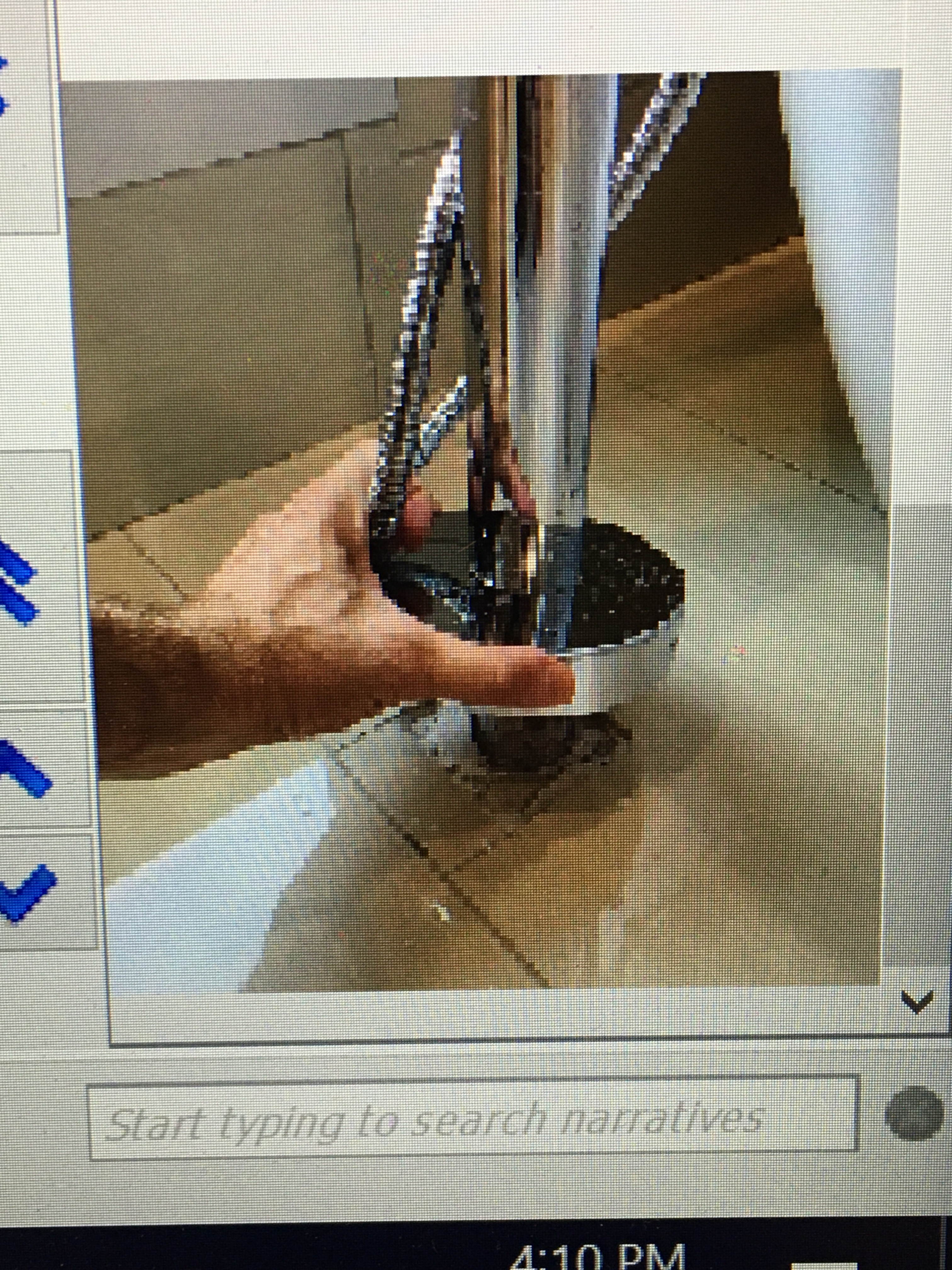

What is the name of the pipe that houses the water lines for the bathtub and comes out of the floor next to the bathtub?
never seen it done quite like that before…not sure there is a name for that …

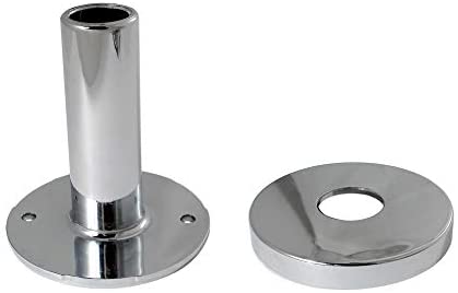

Possibly Keeney plastic flange and tube.
The bathtub faucet is attached to the end of this pipe

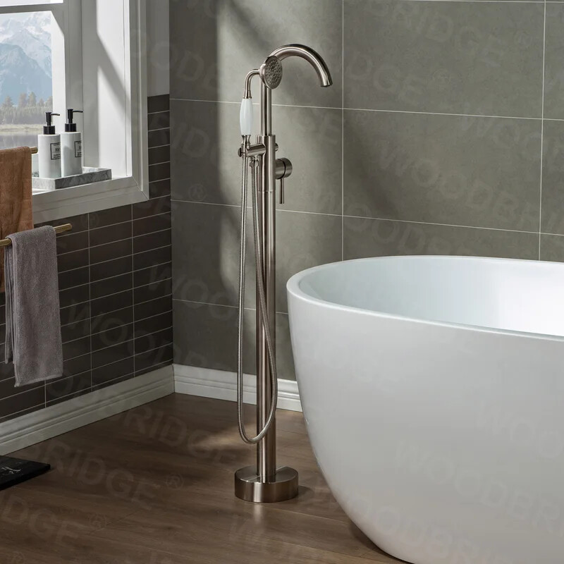

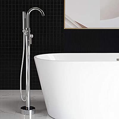

Similar to this?
Floor mount tub faucet…is how I would have reported it without seeing the above link.

Whatever it is, It looks like a nonprofessional installation.

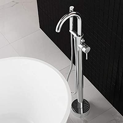

It’s called a stand alone faucet. Expensive fixture. Has to be hooked up from below.
