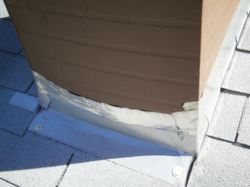

What exactly is this material? Comments? Any info is always appreciated.
Looks like a rubberized material or EPDM, but in either case it is wrong.
Proper step flashing and counter flashing would have been requied for the application to work as intended.

That rubberized wrap is not going to seal out water at the top, so flashing is basically non-existent.

Only metal flashing is excepted as far as I know.
Any type of wrap around is an attempt at a repair and since we not only see a gap in that bitumen looking material at the top edge along with the original metal flashing below it, one can assume there is leakage occurring.
