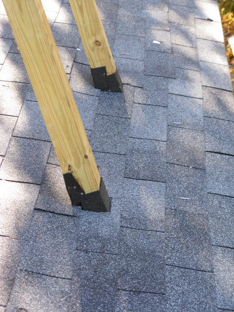

Simply place the stair support alongside the roof edge, and don’t worry about the water entry at the shingle area…
Very nice support area. Simply bang the nails into the top of this roof, it won’t leak…

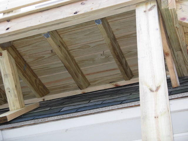

This is the underside of the last pic…
Very secure stringer attachment…
Nice galvanized nails (rusting already)…
Simply place this main support post on a roof top…
