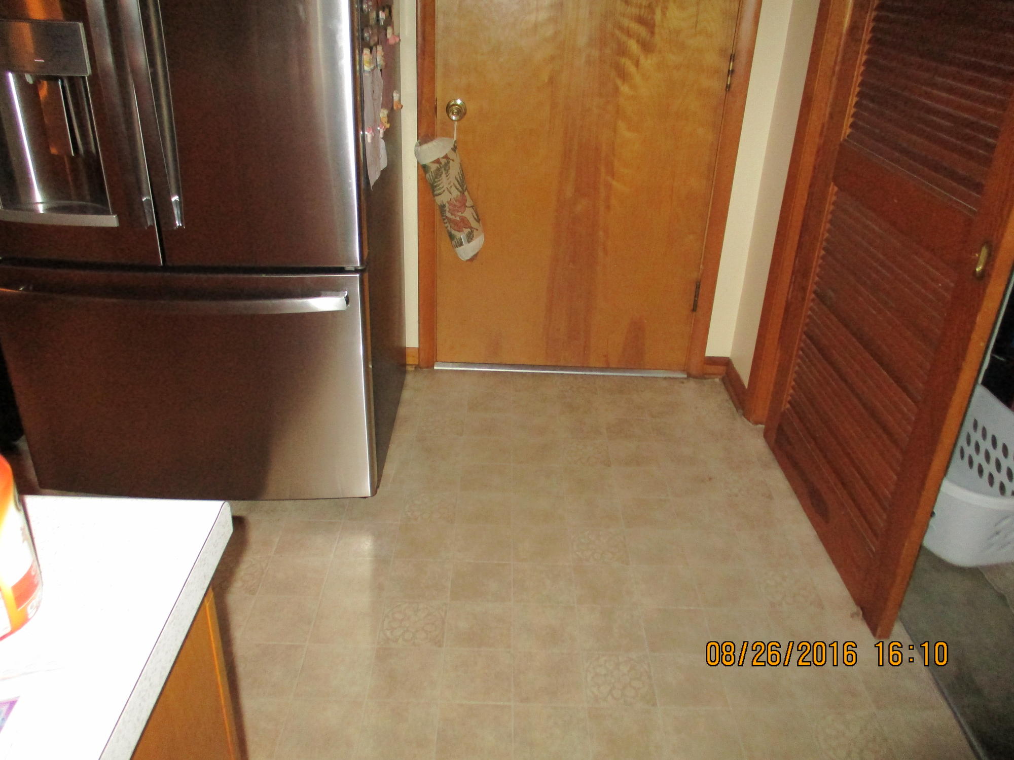

The image is a representation of what a thermal image could detect. This photo is of a current rental that a tenant had removed to paint the casing. When re installing visually you could tell the lack of sealant to prevent energy loss and air penetration. What do you think the thermal image would detect?
