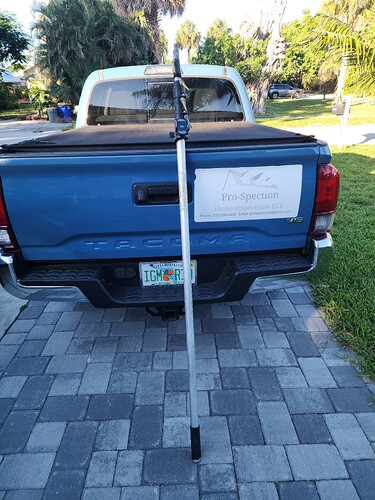

When I was starting out I was going to order the carbon telescoping pole that was $1200. Luckily for me it was out of stock so I just built one myself for around $150. I added a phone holder to it so I could use both hands when fully extended.

I have the DOCA pole that JJ shows. It’s great! I use it for a lot of things but not too often now for pictures. Unless I can rest it against something, I just shake too much for a quality picture. It will work for you younger guys, though!
