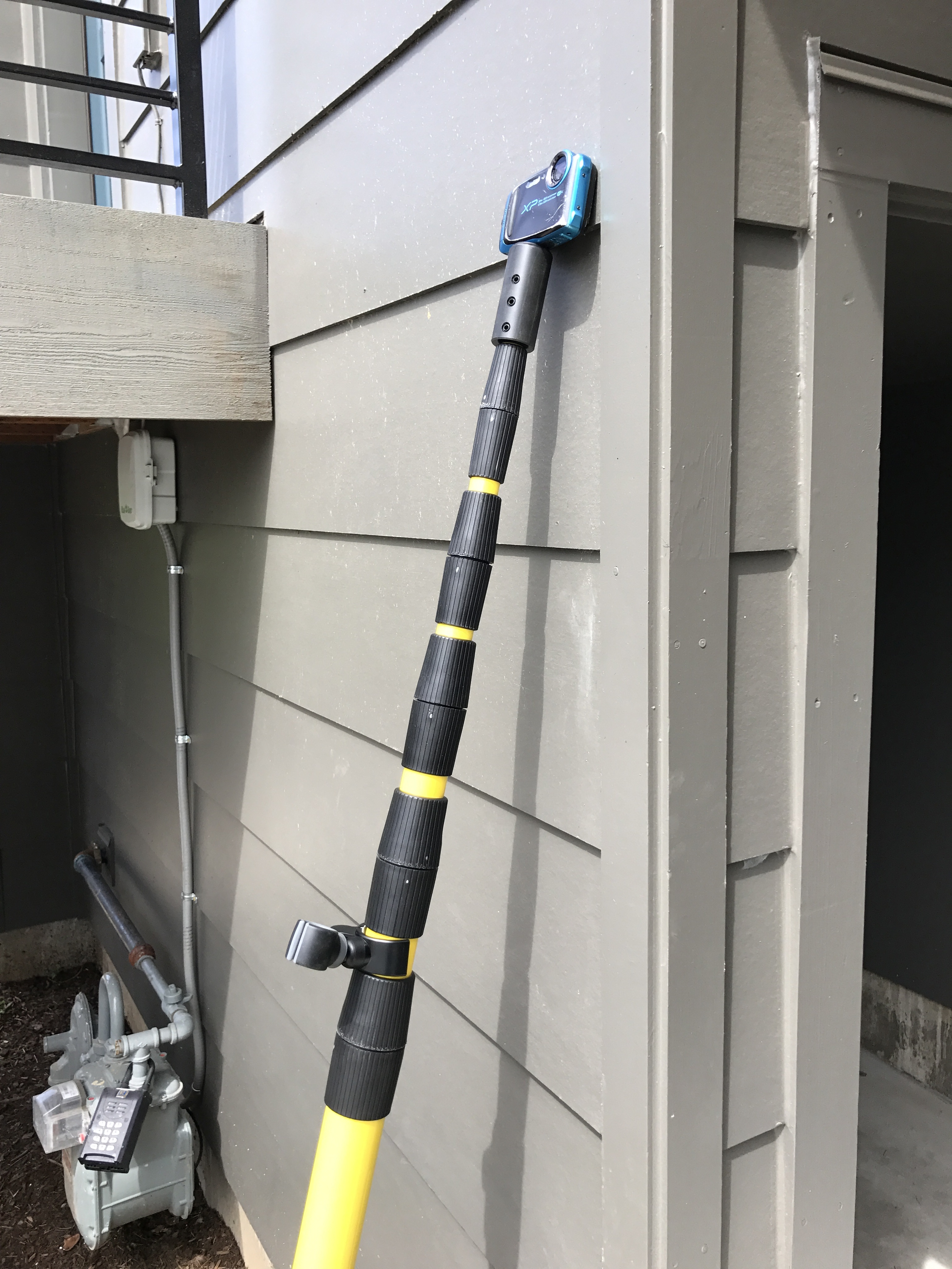

Hi Brett,
My setup is a telescoping pole with a mount that screws into the pole on one end and has the threaded screw for the bottom of the camera on the other. My iPhone has an app that connects to my camera (fujifilm xp130). Once the two are paired I have a phone holder the grips to the bottom of the pole (originally intended to grip handle bars for bicycle), when the camera and phone are paired the iPhone screen shows the camera and has a button to take photos or video.
I use the 30’ fiberglass pole from wonderpole.com
The app is called fujifilm cam remote.
Good Luck,
-Patrick

When the pole is maxed out it definitely sways a bit, thankfully the camera doesn’t weight much so it’s manageable. Otherwise I lean the pole against the gutter (gently) and move in 4-6ft sections around the perimeter. A two story house the pole doesn’t move much. You can place the base of the pole into your hip or pelvis to stabilize too, but it’s not usually necessary. I also have an extruded aluminum pole (doca pole) that is 24’ it’s more rigid than the fiberglass but I never use it for fear of electrocution.

Yes I take pictures of several aspects and different directions, I’ll zoom in on as many things as I need, flashings, penetrations, chimneys etc.
Then I’ll review the photos afterwards. The phone shows you a live view of what the camera is seeing so you can watch your screen and notice defects right then too.
