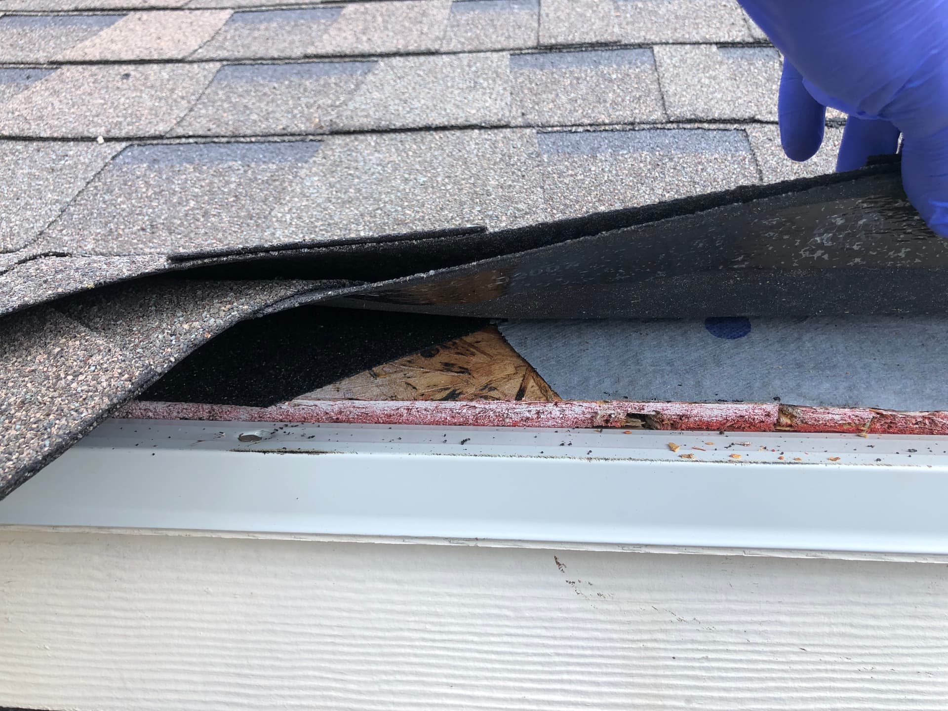

2. Drip edge flashing was added to the house for the first time since it was built. This is how they installed it. My understanding is it should be attached to the decking itself and it’s attached to the trim here. The positioning of the existing decking seemed to prohibit that with the drip edge they installed, should they have used a different drip edge with a longer top section to accommodate for the decking? (and I know, the starter strip backing wasn’t removed and the underlayment doesn’t extend enough.)
edit: ive since researched the manufacturers installation recomendations and learned that is not an adhesive strip on the bottle and the cellophane should not be removed. regardless, the dripedge-underlayment-starter strip area seems to be improper
Drip edge flashing is wrong
I do not have a problem with the apron flashing. Some sealant under the apron flashing should suffice.
I would use fasteners. I see no problem getting fasteners under the overhang. The builder has to put more thought into it, not a problem. It would take 5 minutes to fasten it down.
Yes, improper drip edge
Right, right. I knew that. I guess thinking that the strip on the bottom was adhesive threw me off from what i knew was important. Thank you Brian and Scott.
Wait. was there underlayment?
you can see it in the picture, it comes to the end of the sheathing.behind the drip edge
pretty shoddy job though.

It should cover all of the roof decking.

PROBLEMS
problem 1 they should have lowered and nailed the underlayment down to the drip edge, not to the OSB .
Problem 2 Wrong type of drip edge used. that stuff is used for flat roofs, not shingle.
Problem 3 the shingle overhang over the drip edge is way to far. use the correct dripedge and no overhang needed.
