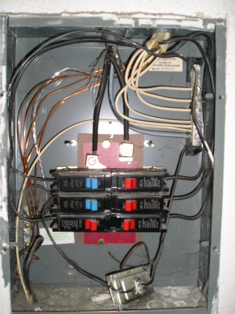

Here’s another from today. . .
I am not sure what your video is about, here are a couple you may want to use.
(I posted them the same size I took them)
Not only the Transformer in the panel, but KOs missing
http://i158.photobucket.com/albums/t96/etsny/bellxformerinpanel.jpg
Strands cut to fit the Circuit Breaker
Jeff, That’s perfect. And not allowed. Thanks.
I noticed that in your last pic, there were three different breakers in that panelboard. Square D, Challenger, and a third (almost legible). I wonder if that is permitted, as written on the cabinet label.
Pierre, Awesome. Great shots. Thanks. In my video, we speak about cutting strands.
It was quite a hodge-podge of different breakers.
Cuttler Hammer, Square D, Challenger, GE, and one other that has slipped my mind. . .
