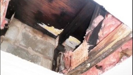

We have alls seen the problems with split faced CMU block, and I have also written about the 2nd, new phase, the problems with water wicking into the wooden floor and ceiling trusses and the possibility of structural collapse.
The local TV station, ABC 7 is doing a special on this issues to which I contributed. Typically, the sensationalized it a great deal, calling the piece “Designed to Collapse” or something like that.

Split faced block, in this area, is a single wythe masonry wall. You cannot, as she said, “remove and replace” the block. That would mean totally demolishing the building and rebuilding it with the same (defective) material! WTF!!!
The Seal Chicago guys are full of it. Why the heck are they power washing the block (already water logged) before “sealing” it. The only effective, lomng lasting solution is an elastomeric, plugger type paint.

Notice that the “sealer” company was power washing the block. Why put more water into the block beforeyou “seal” it.
They are using a penetrating sealer (Dynacrete) which only lasts for 3 - 5 years, in this area (UV breakdown). The best solution is an elastomeric “plugger” type paint. It usually lasts some 20 years.
Notice what the “talking head”, Cheryl Burton (who never was involved with the producer of me, during the actual filming), actually said at the end. She said that we (HIs) said that the best solution is to “remove and replace” the block. How does one “remove and replace” a single wythe block wall without dismantling the building? And why would one “replace” this product with the same high maintance material. Just build a double wythe brick and block wall?

As a 32 year Bricklayer that has worked with Split-faced block, the blame falls directly on the contractor that installed the product. Properly installed, these split faced units DO NOT leak. Un-qualified mason contractors are totally to blame, most of whom are using someone elses contractor’s license to get work in the City.
I would, mostly, agree. Licensed, union trained masons are the best. But that is because the unions, through many court cases and because the City has no liabilty, and because the unions have priced themselves out of the market, they shot themselves in the foot, and left the public in Chicago, with this problem,

For the producer to review. But only the pictures (the details of the removed and gutted top floor, used in the report) where mentioned.
