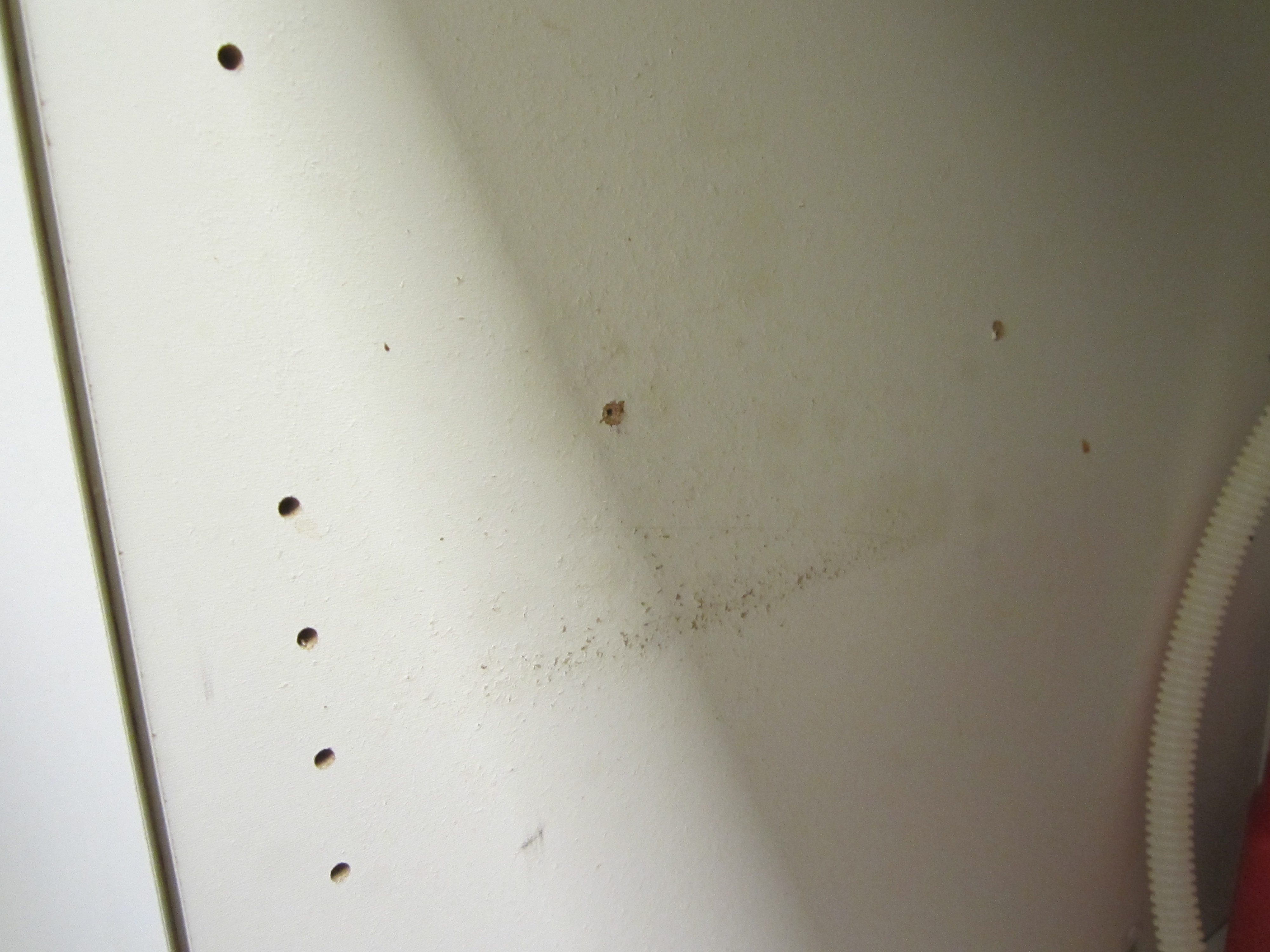

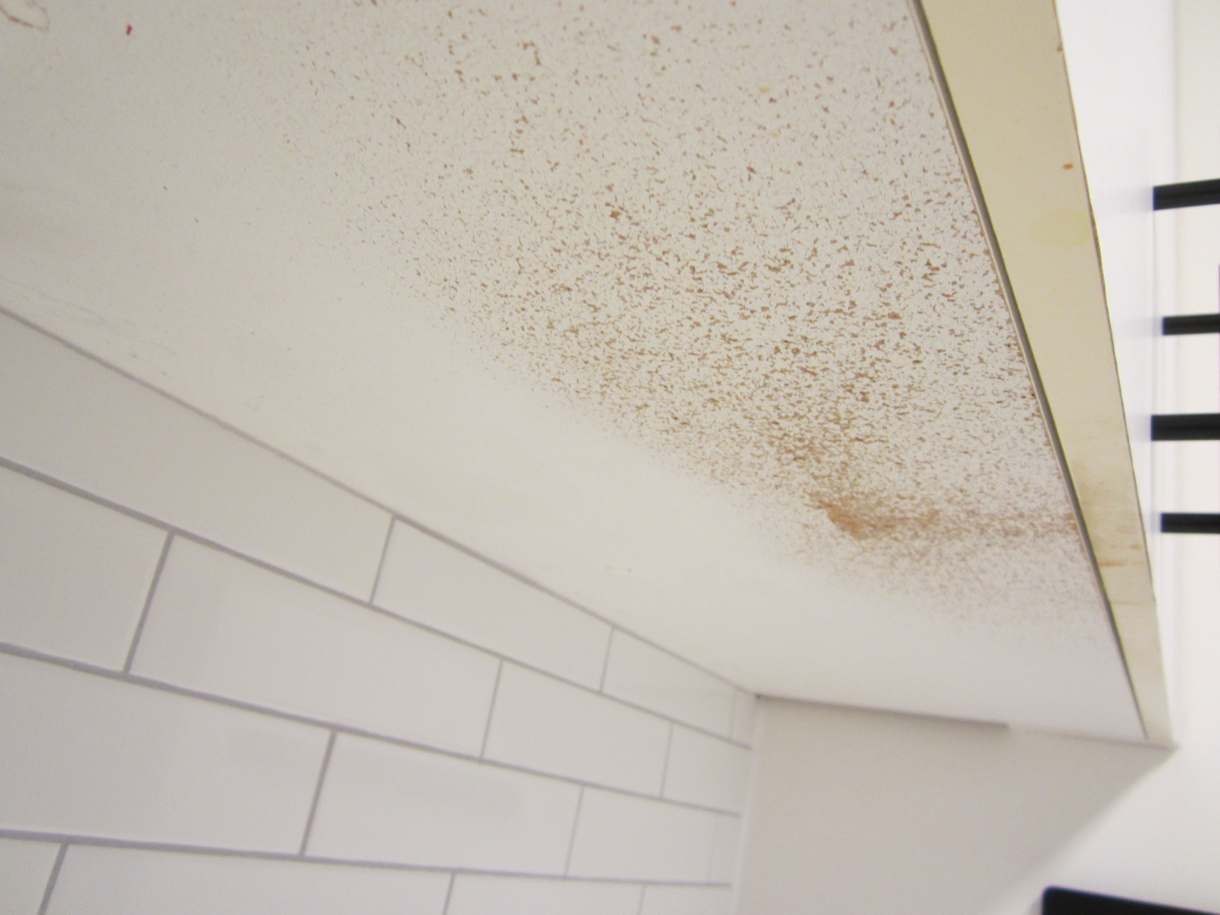

I did an inspection on a condo at the end of August; the client got possession 2 weeks ago. Now she’s coming back and saying that I missed a “significant” problem in the kitchen. There is paint degrading on the particle board cabinet undersides beside the sink, and a unknown stain on the side of the cabinet under the sink.
I haven’t responded yet. In my opinion when I look at the pics it’s cosmetic, and that is why I did not include it in my report.
Opinions?
IMO it’s normal wear and tear and is not impacting the function and use of the cabinets. Yes it does not look good. However, you are dealing with a Mars VS Venus situation and my experience is that Venus clients are always concerned about appearance conditions and feel that an existing home (used) should be perfect. I’m certain that she would of canceled the deal over these conditions. Right? I don’t think so.

Composite Lumber. Which type? Typically/usually, MDF.
Think of a painter on his knees…Lunch time in 5 minutes. Gets a call. Boos calls him over. The painting did not get finished because you can not see it.
Under the cabinet the caulking is not continuous to the wall. Second image. Far right side.
The MDF has mechanical damage from previous screw holes.

1: Did you run your hand along the surface to feel if the MDL was smooth?
2: Is there a heater of any kind under the counter?
“insignificant”
The under sink marks are from hanging a wet dishcloth on a hanger. the under cabinet stains are from a steaming pot or coffee maker.

If the doors opened and closed, the cabinets were securely affixed to the wall, and the shelves held their customary loads, then the cabinets are functional. Chips, dents, stains, and scratches are wear and tear, period.
The last thing you want is to have to explain a one-star review on your page for missing something cosmetic. If the material does not need replacement it is clearly cosmetic, and that may be your best response to the customer. Offer to paint it or have it painted and smile.
