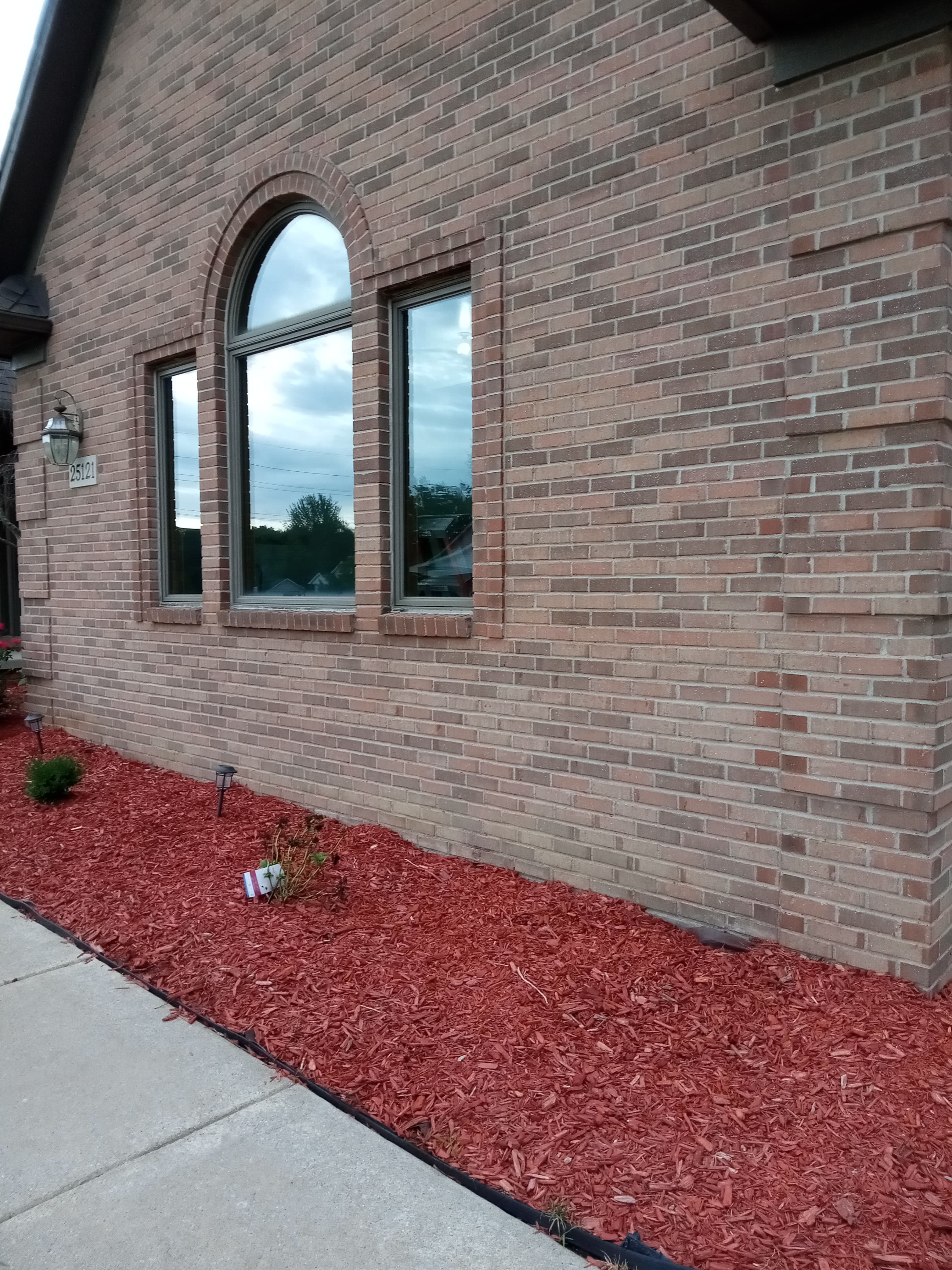

I’m in Michigan looking to purchase a home with a basement. There are cracks on all four walls. The cracks were filled in and painted over. The homeowner does not have much info about the repairs. What do you guys see just by looking at the photos. Are these cracks something I should be concerned about

It is on a corner lot next to a busy intersection
Exterior is brick veneer with NO weep holes. Husband passed away and wife knows nothing about the repairs.

Are those pics the same wall? Looks like it is a short wall the juts out at both ends?
Or is that pic of the exterior the same wall?

The crack in the pic appears to have been injected (Likely epoxy) and then parge coated to present a uniform appearance. If done professionally it usually comes with a pretty good warranty against leaks. If done by the homeowner or a flipper usually not.If the house is covered in brick veneer and has no weep holes I would not buy it as that is a major construction defect.
My home has no weep holes and has been performing well for sixty years. I’m curious how old the subject property is.
