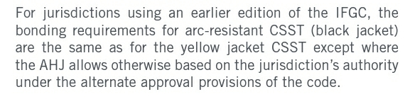

We can all agree that iron/SS gas piping systems need to be bonded.
Additional bonding is not required on some material, Michael. Specifically Gastite Flashshield and there are others.
I was able to get with a mechanical contractor friend and the manufacturers representative that certified me in installing Gastite Flashshield.
Both indicated there is no need or requirement for additional bonding on this specific CSST.
What is the take away here when we’re in the field inspecting?
The yellow vinyl coated product does not have the braided layer between the vinyl and SS pipe and needs additional/direct bonding. That should be noted on an inspection report.
The other black vinyl coated CCST product most likely not, IF the proper label is on it.

Depends on what IFGC is being used.
New inspectors need to know that what is/was codified is the law of the land. Not what I say and not what you say.
